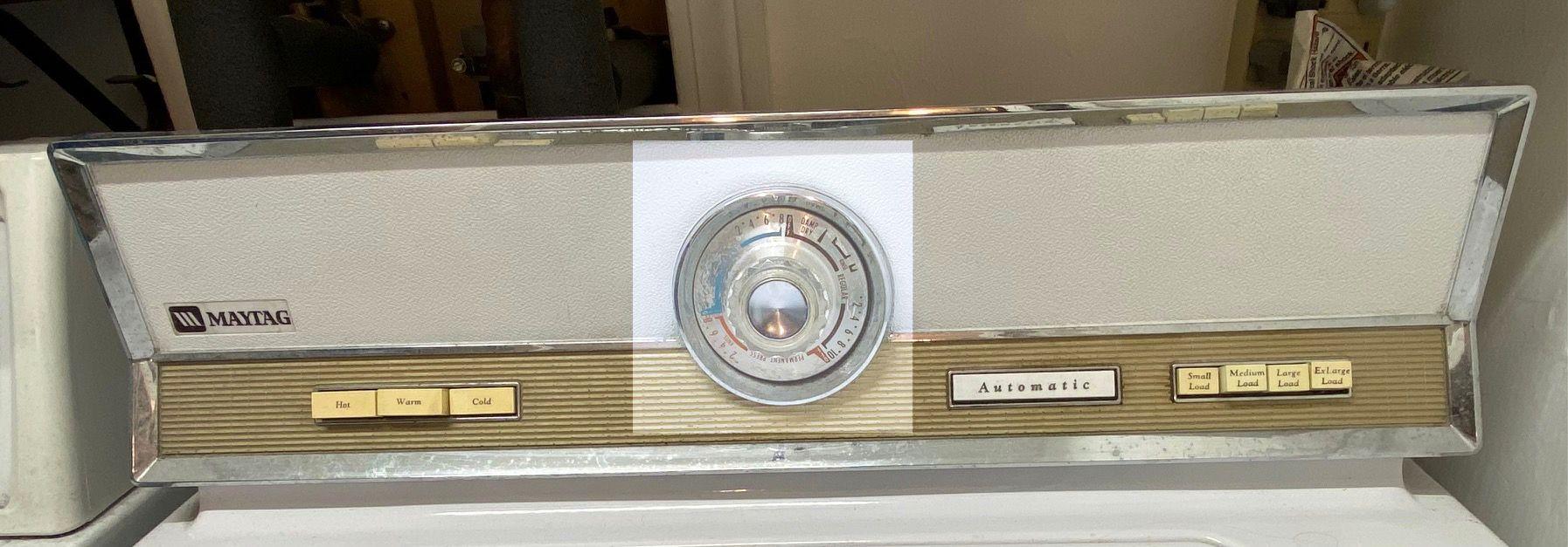

Maytag A308 SN 912752 CA - Mid 70's machine fills and starts by itself.
pjw73nh
Yes, as strange as it sounds, I'm sitting at my kitchen table this morning and I didn't really hear it filling, but I DID hear it when it started to agitate.  I went over to look at it and it was full of water, no clothing (expected).  The selector was on extra large (usual for us).  The timer dial was on the blue (delicate) cycle. We have NEVER used that cycle since we owned this machine (1979).  The blue/delicate cycle is immediately after the end of the brown (regular) cycle. I was the only person in the house at the time.
Any thoughts or suggestions?
Thanks.
Sounds like a bad timer. Been not available for a while though. Make sure the timer knob pulls/pushes in and out freely and there isn't something binding causing it not to engage/disengage properly. If the machine still otherwise works, I'd just plug it in to a power strip or something with an on/off switch and control it that way as a master shut off.

OK. So here's where I am. I was able to reproduce the issue today.  Yes, there is, in fact, an issue.  I'm 70 years old, I've kept my A308 alive, maintaining it without too much trouble for 50 years (Since 1975). It owes me nothing. I've got probably $75 in parts invested in it.

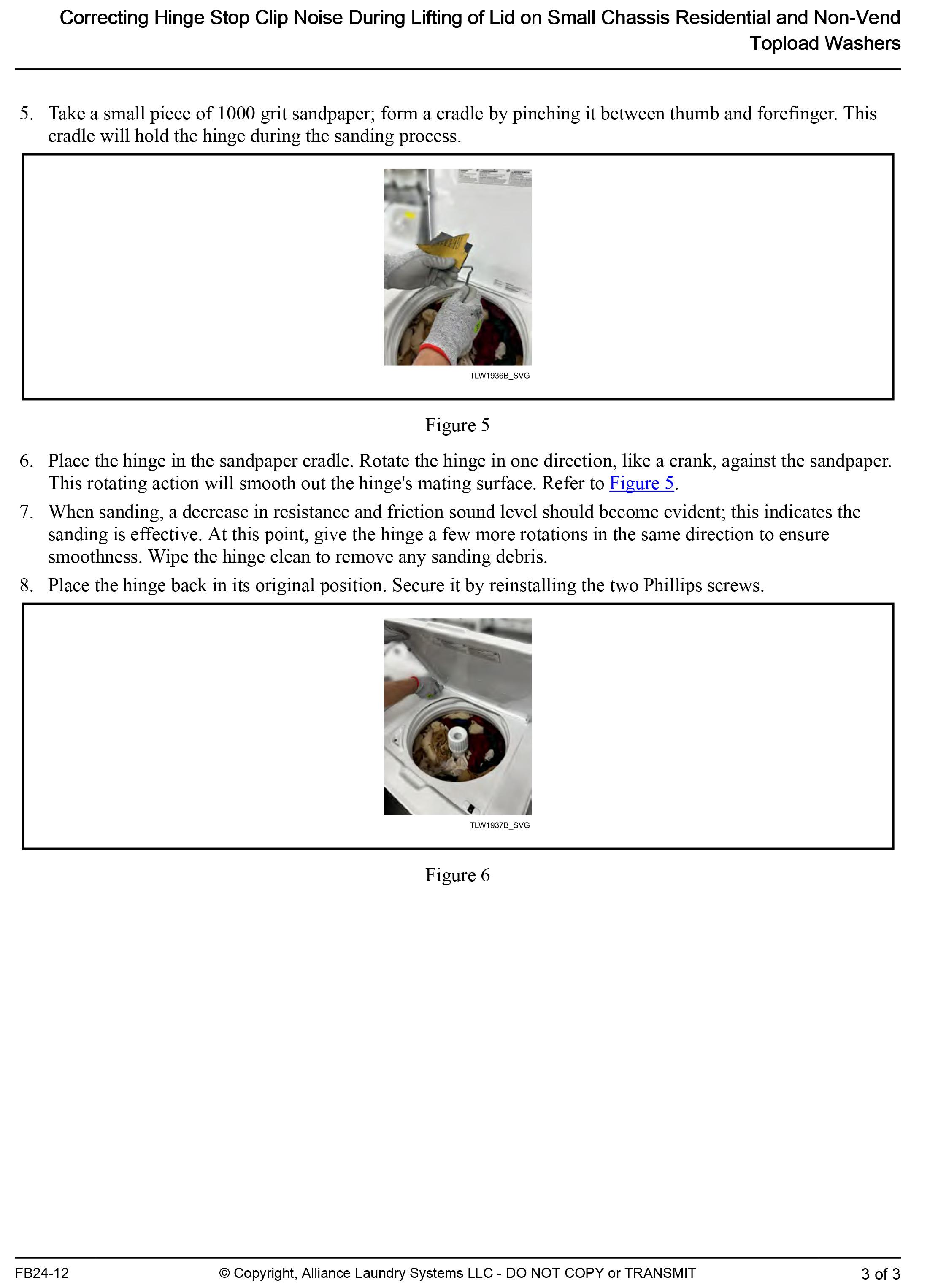

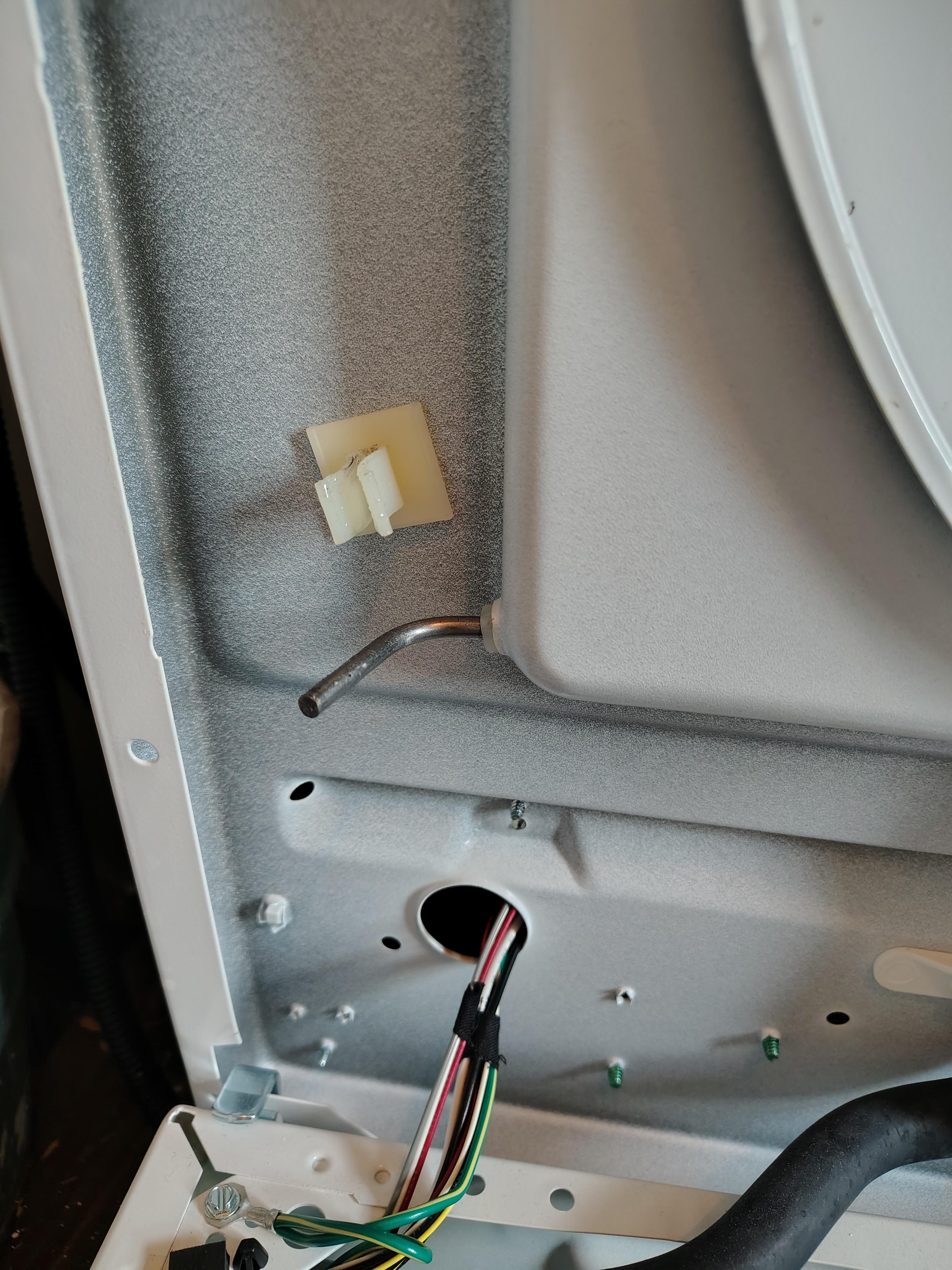

My real question is: The lid makes a "groaning" noise at the top of the swing.  I am going to try and attach a video of it.  Please tell me this is an easy, inexpensive fix and I don't have to place a service call on the washer.
Thanks again for all your help.
pjw73nh
I should've added, the noise is from the left side hinge. I tried loosening it a bit and retightening it, but it has self centering screws and there is no "play" in it. Thanks.

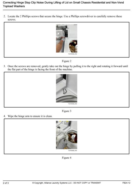

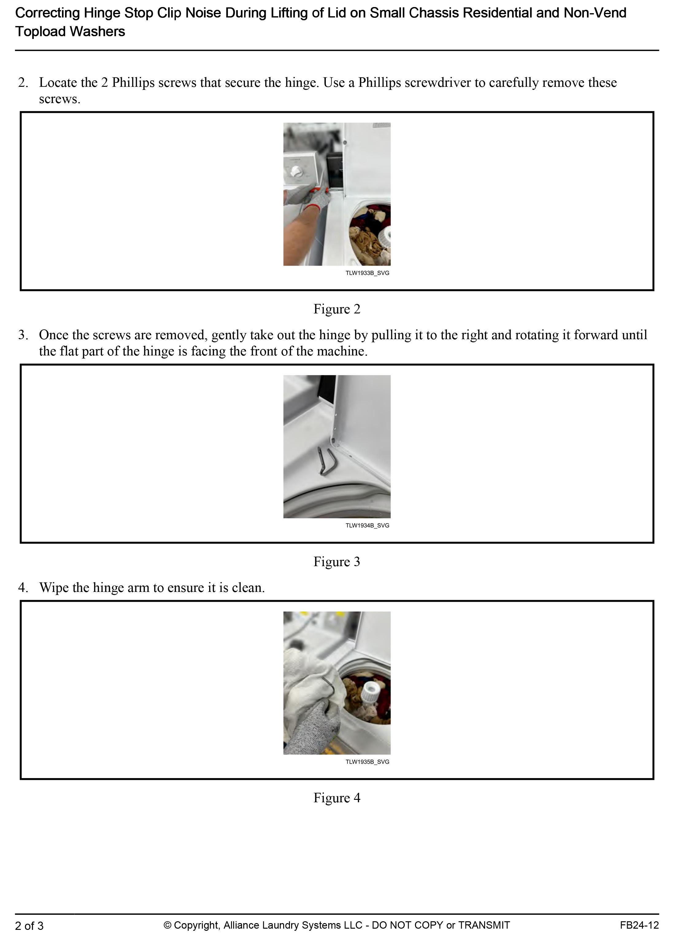

I cehcked for the buckle in the lid. Nope. Pretty flat, I even tried gently to see if it would"pop/  Nothing.
I undid the two screwes holding the left hinge. I could pull the hinge out about 1/2" but I couldn't get it our all the way.  I lubed it up and it made no difference.
Can you give me a little bit more detail on >>>make sure they removed the shipping plug under the unit.<<< and the best way to locate and remove it?  Do I have to tip the unit on it's side or remove coveres?
Thanks.  Paul
Just pull the unit away from the wall and tip it back so you can look underneath. If the plug has been removed you'll just a 3" hole in the bottom of the base pan.
As far as the lid, you said it's pretty flat? It should be raised up in the center about a ½" or so. I see this so many times where people push the lid in and it makes it make noise.

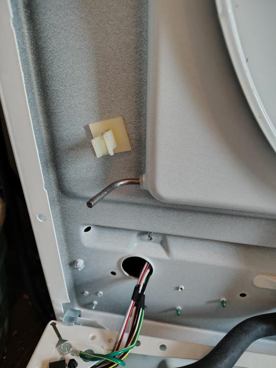

If the lid is not buckled, the noise can happen due to friction where the hinge arm rubs into the retainer clip. There is a little plastic clip with wings that is stuck on the underside of the top. When the lid is opened all the way, those "wings" grab the end of the hinge arm to hold the lid open. There is a service bulletin on this and if we run across it, we're supposed to sand smooth the end of the hinge arm where it contacts the retainer clip. It's not really a big deal. You can pull the hinge arm all the way out by pulling it out to the right like you did, then rotating it forward and pulling it out. Then sand smooth the last inch or so of the hinge arm end.
Lubing it can help but you have to lube it at the very end of the hinge arm under the top, not just where it goes into the lid. The sanding trick is a more permanent fix per Speed Queen. I'll see if I can upload the service bulletin.

Well... I confirmed the shipping plug is NOT there. I was able to suffiently level the washer per your instructions.    However, I tried to rememdy the left hinge noise but was unsuccessful.  I was able ot remove the hinge, sand it (with 880 grit) that's all I had available.  I re-lubed it, re installed it and I am left with the ame issue.  Not a show stopper, just annoying.  And a bit insulting after paying close to $1300 for a high quality washer, and it's not perfect.   I'm not going to lose any sleep. One last question. How is the water/load level set? I didn't see any controls other than "Deep Fill".

I attached a pic I took today of the super high-tech lid retainer clip I was talking about, for your reference. You can see the two "wings" on the clip that grab the hinge arm. You can apply some silicone grease to the wings and that should help. You can do this from the top of the machine. With one hand, push the inner tub to the left-rear as far as it will go (you may need to hold it there as you are fighting the tension on the tub springs). With your other hand, close the lid slightly so the hinge arm comes out of the retainer clip. With your third hand, take some silicone grease on the end of your finger and reach up under there to apply the grease to inside wings of the clip.
That said, you said before that your lid looked flat.  If you open the lid and sight across the top of it, it should have an obvious rise in the center of the lid. It shouldn't be perfectly flat.

Hi,  The lid is NOT flat. it has a slight arc to it.   I was able to silicone the "winged" hinge lever catch, but it mad no difference.   How does the top flip up like in your picture?  Maybe if I had better access to it  I could get it lubed better.

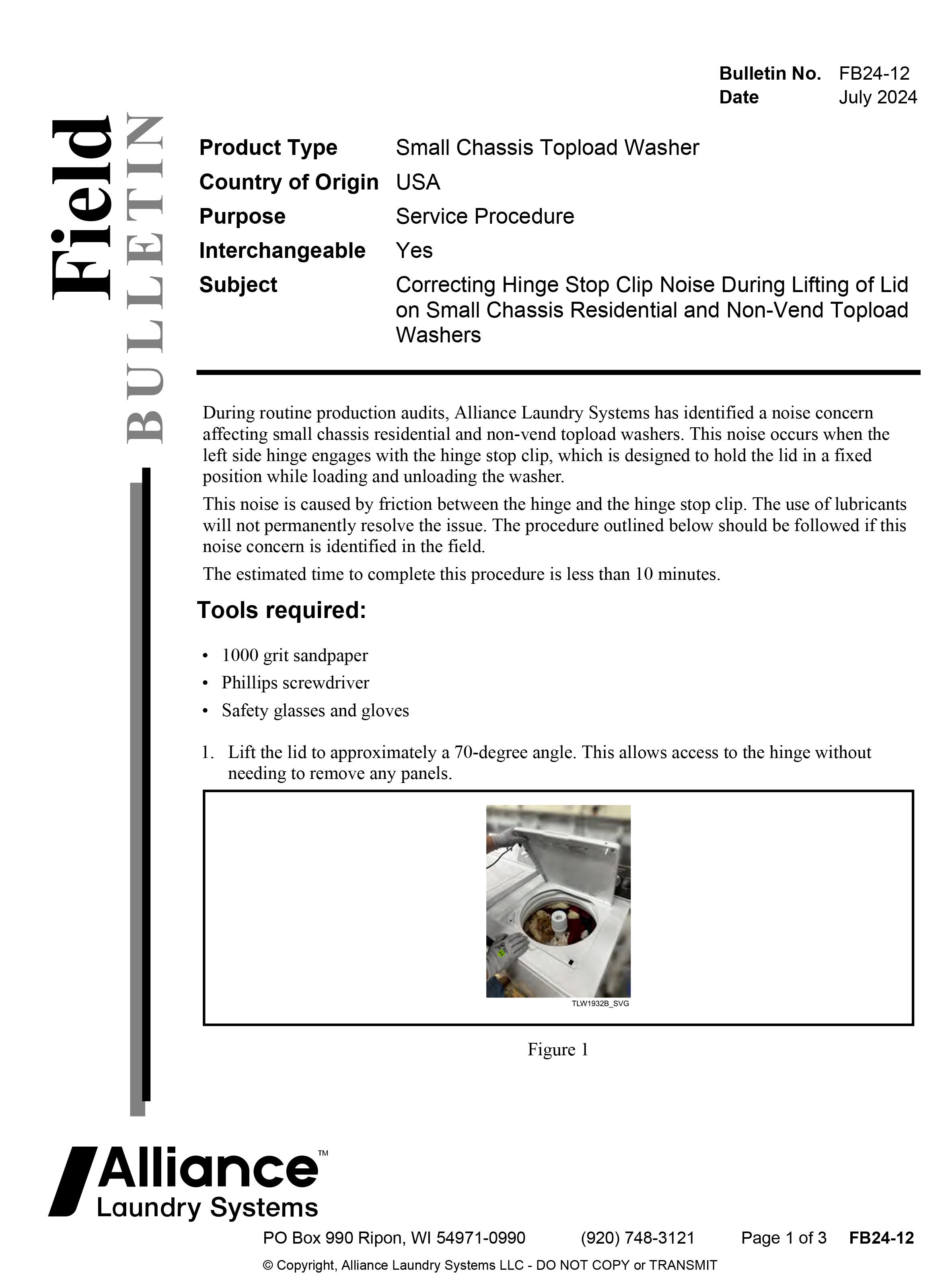

@citizenX Is it possible to upload that FB24-12 Bulletin when you get a chance?

The top doesn't just lift up. You have to remove the front panel first (two 5/16" screws at the bottom) and then two screws under the top front corners. Then it lifts up. Just hang on to the lid.
If the lid has an upwards arc to it then it's not pushed in. Not sure why you're still having the hinge noise.
Will do when I get home
