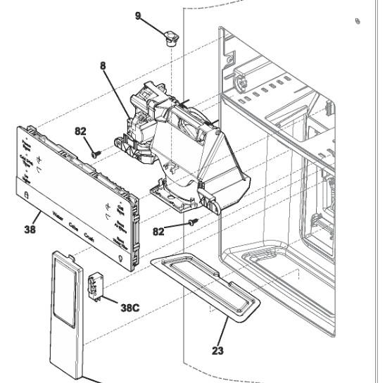

Frigidaire Model GRSC2352AF0 Serial Number 4A13403440 How to Remove Control Panel
JimmyJames
Hello,

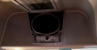

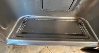

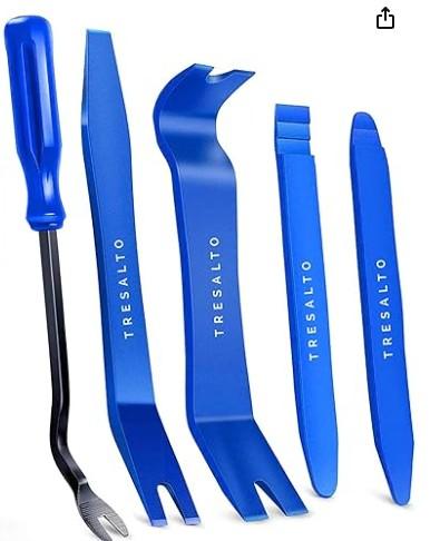

I need assistance. I am trying to reinstall my sister's water despenser hose. It has been pushed back inside the control panel recess. I do not want to break any parts removing the control panel.  I do not see any screws to remove that allows access the control board.  I have attached pictures of her appliance's dispenser door assembly, drain tray installed and removed, ice chute and missing water tube.  Plus a diagram of the control panel, push pad and the tools I have to remove the panel if it held in by clips.  Thank you in advance for your help.

Just for the next person who needs this, it pops off, no screws. It's hard to get a tool in there but you can, and then start going around popping it out.
