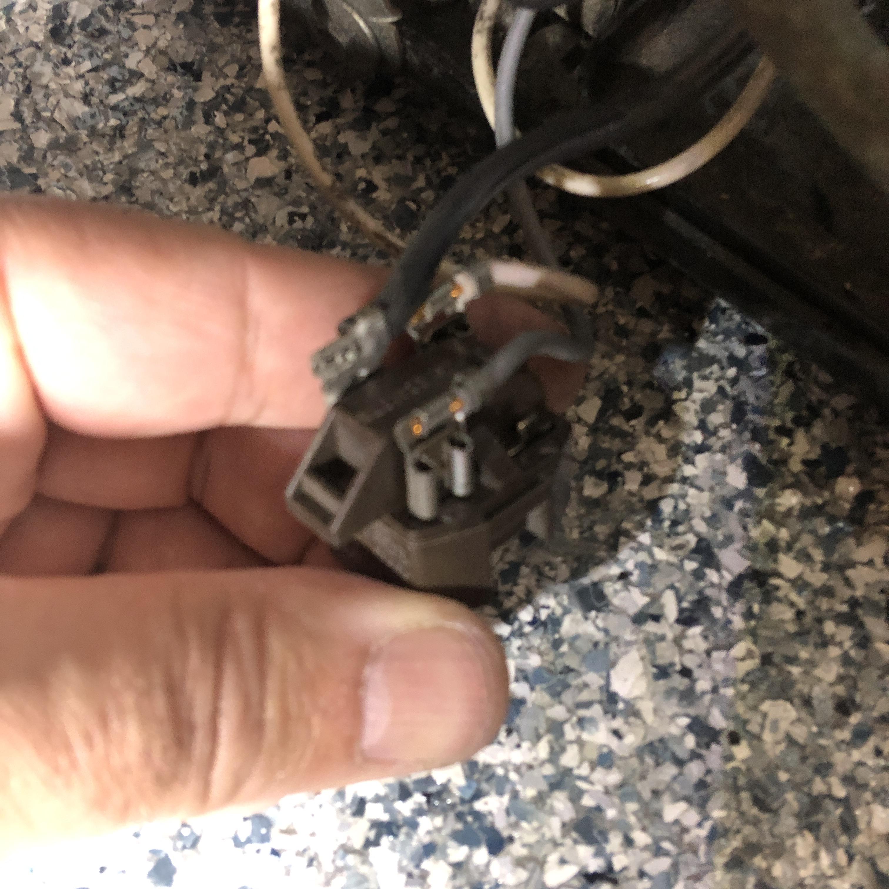

I have an old Amana refrigerator that has stopped cooling down. I have done the following and still cannot get the compressor to fire up:
1. Checked compressor pins for continuity (beeping ohmmeter) and all 3 pins work,

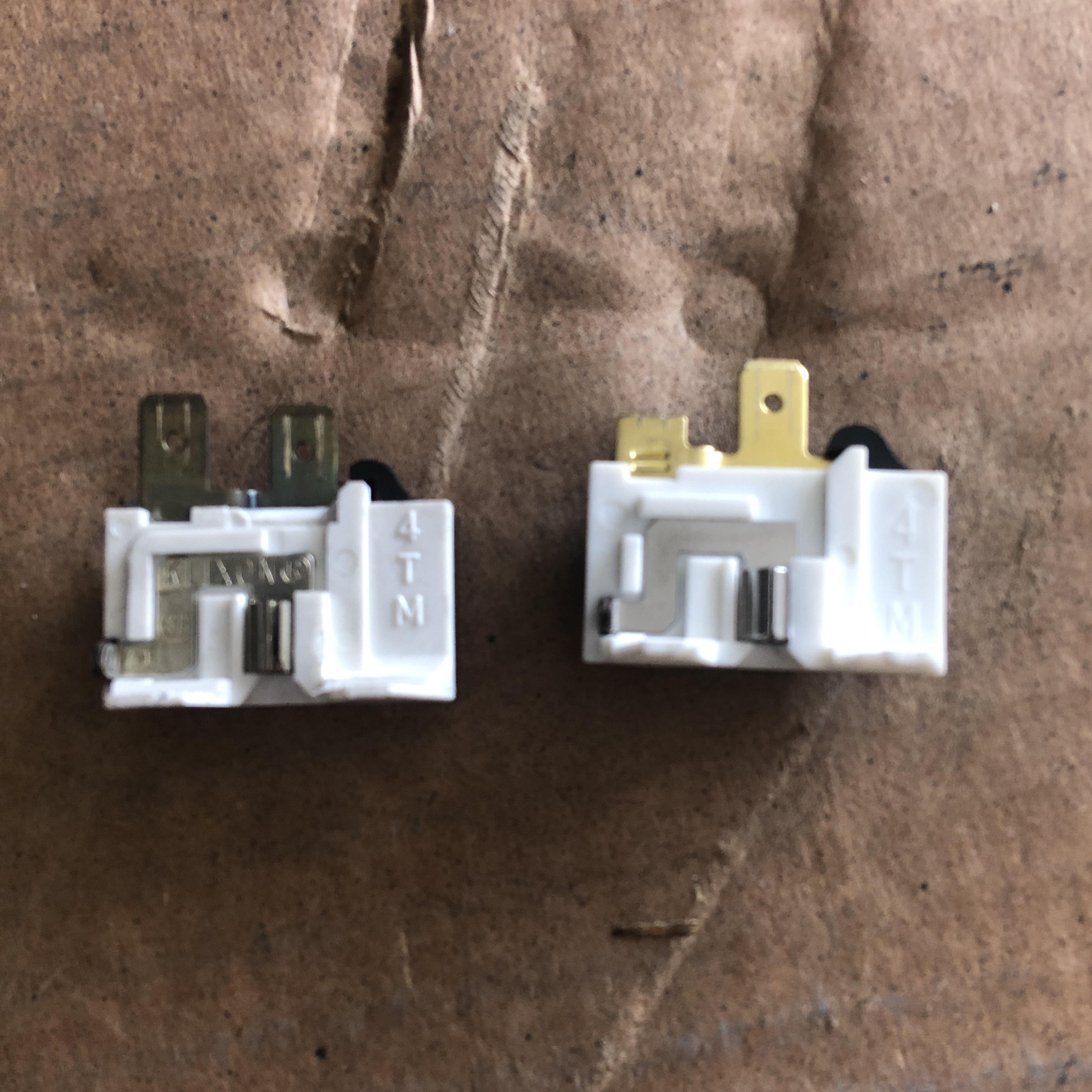

2. I have replaced the overload relay (see photos of the relay kit),

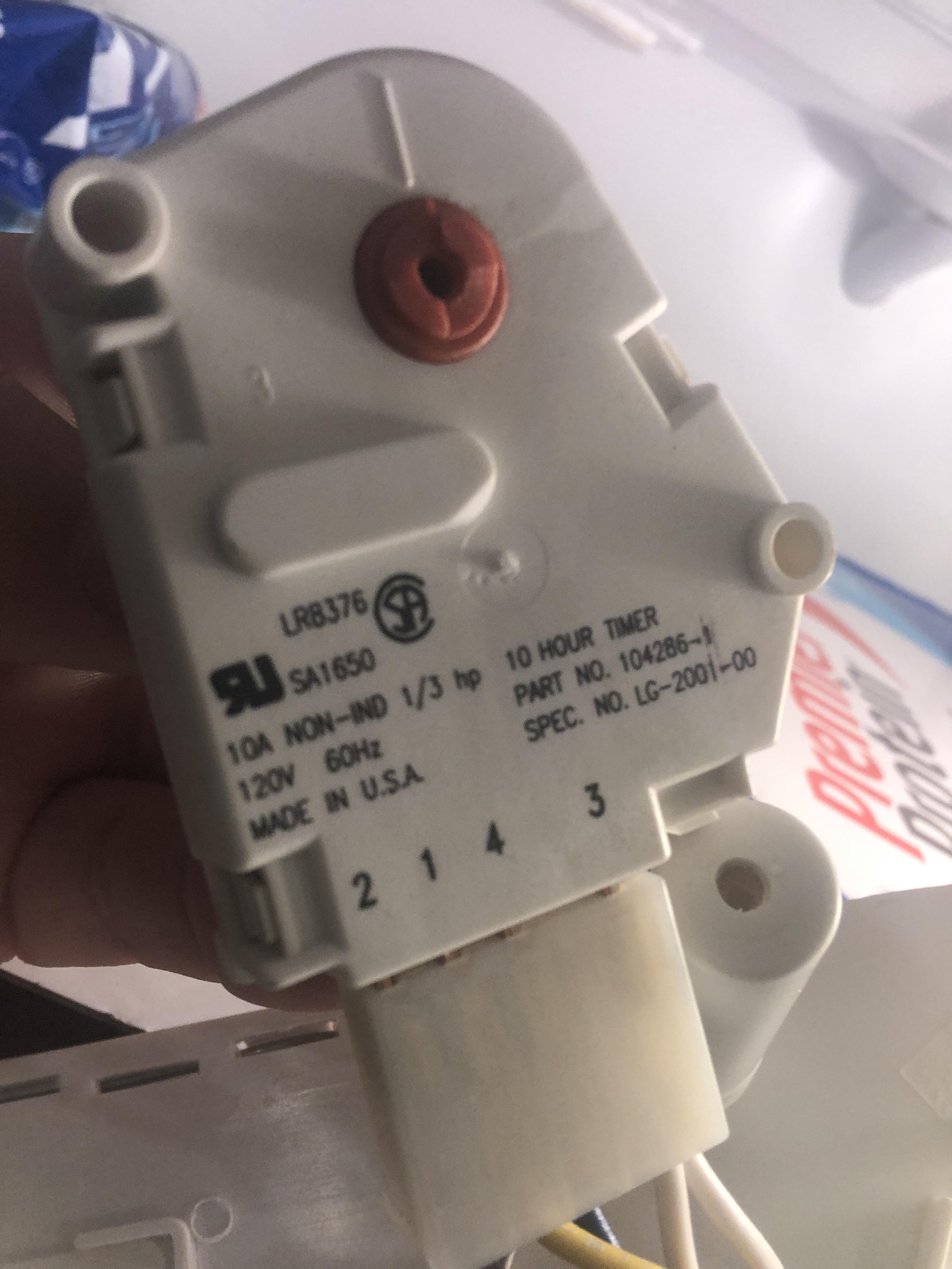

3. I have replaced the refrigerator defrost timer (see photo of defrost timer), and

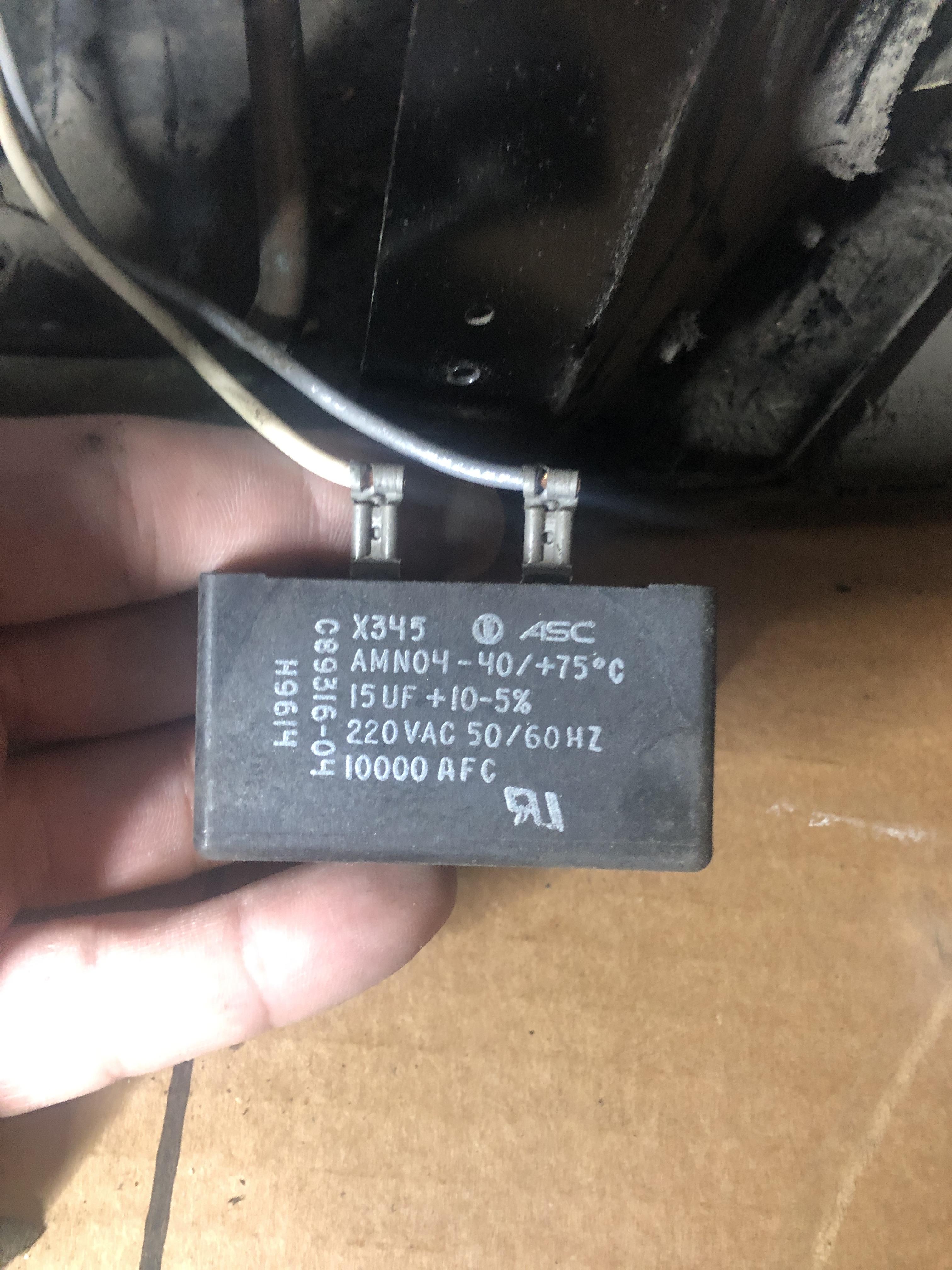

4. I have replaced the run capacitor (see capacitor photo),
I still cannot get the compressor to run. I hear it clicking but it won't turn over. After a few minutes, the top of the compressor starts to get hot, and it still won't turn on.

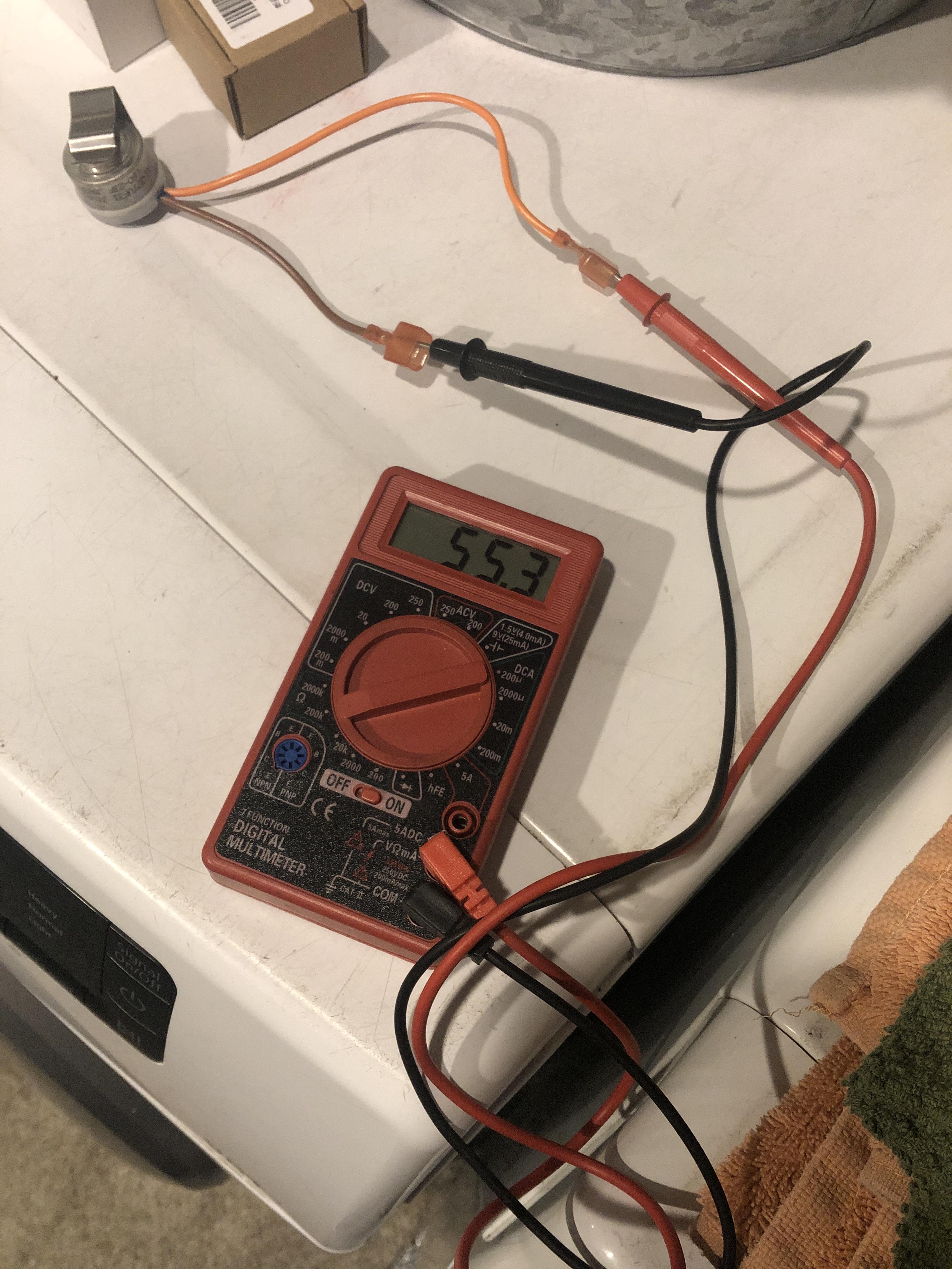

I HAVE NOT changed the Defrost Thermosets yet. I have tested it, and my ohmmeter shows proper reading (see attached photo of Defrost Thermostat).
