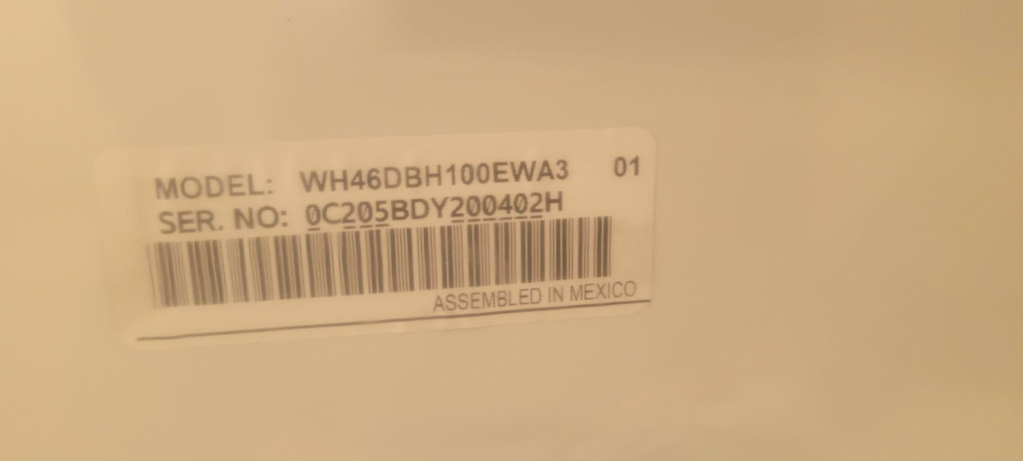

Manufacturer: Samsung
Type of Appliance: Dryer
Model Number: WH46DBH100EWA3

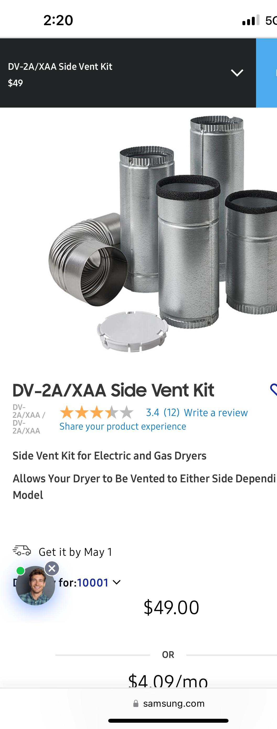

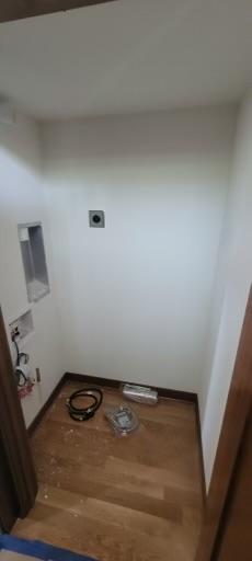

Looking for an installation manual. Customer doing remodeling project, bought Samsung Bespoke Stacked Laundry and side vent kit.  Remodeling contractor wants no part of side vent conversion, but is willing to complete installation once side vent conversion complete.

I believe customer purchased kit is DV-2A/XAA. Looks like they want to vent to the left.

Found the service, training, owner's manuals and part list. Peek at part list the dryer cabinet has a cutout on right side lower back area for a vent. Presume the Kit is just 2 straight  and 1 elbow pieces.  Probably have to take the dryer front and drum out to make the changes.  Uploaded pending approval.

Thanks. Job went well.
Was able to do the conversion through the rear and side vent openings. No disassembly, but high risk of sharp edges: wear sleeves.
Knockout side port and there is plenty of room to work. Taping elbow joints properly is the biggest challenge.
Long Phillips extension (with magnet) needed to secure front mounting screw.
Taping joints, difficult but possible.
1/8” drill bit needed for pilot hole exterior mounting screw.
