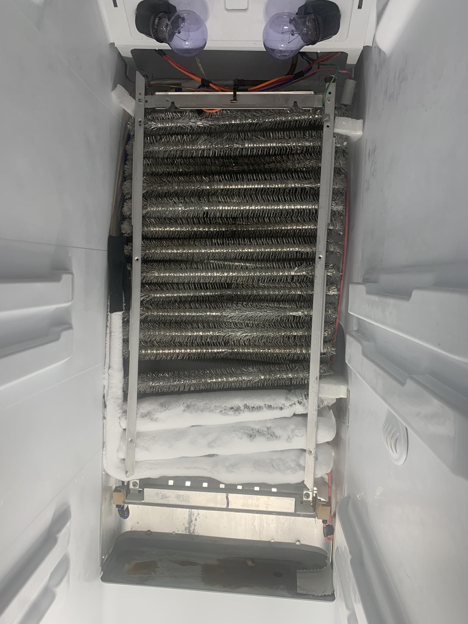

Thanks for this information.  Yes, I agree the sealed system has an issue, probably a leak.  @Budget Appliance also suggested this earlier. I had hoped it was the inverter.  The problem has been progressing and as I mentioned earlier, both the fridge and freezer have gotten warm.  I pulled the rear freezer panel to find that the bottom 3-rungs of the evaporator are the only ones with frost (picture below).  Defrost heater checks good.  I then measured good line volts into the inverter and line current of 0.7 amps which I think is also good.  The control volts into the inverter ranged from 4.7 to 5.4 vdc and about 60-63 Hz frequency.  Compressor was about 10degrees F above ambient.  Condenser was barely warm.  None of the tubes were warm or cold.  I think this all suggests the inverter is doing its job and the compressor at least has good electrical continuity.  I noticed a black oily substance at the rear right side on the floor that was spread around by the roller wheel when I rolled out the unit for testing.  I think this all points to a closed system leak.  Several months ago, the floor under the fridge was clean.  I assume this would be more than $500- to get a tech on it, so I don’t think it makes sense for a 15-year old unit. Might be time for a new one.  I do have a few questions just for my education:
  1. Does the frost pattern suggest low freon?  Does it tell us anything at all?  The picture was taken after the unit was in operation for a long time.  After being on for only 30-40 minutes, there was a light frost on the bottom two rungs only.
  2. Was the black oily substance on the floor consistent with a leak?
  3. Why do closed systems develop leaks like this if that’s what we’re looking at?  It seems a leak would require a puncture, so if no rough treatment there should be no leak, right?
  4. Am I right that this would cost more than $500- to repair a leak?

  • Solution
The frost pattern indicates a sealed system problem.
Sealed system can develop leaks over the years, tubing braze joints can crack/fail, tubing can corrode and other things.
I doubt the black on floor is oil - if so you most likely wouldn't see any cooling at all.
Probably not worth repairing - leak has to be found and repaired and may need compressor or other parts, (most likely easily 500+).
