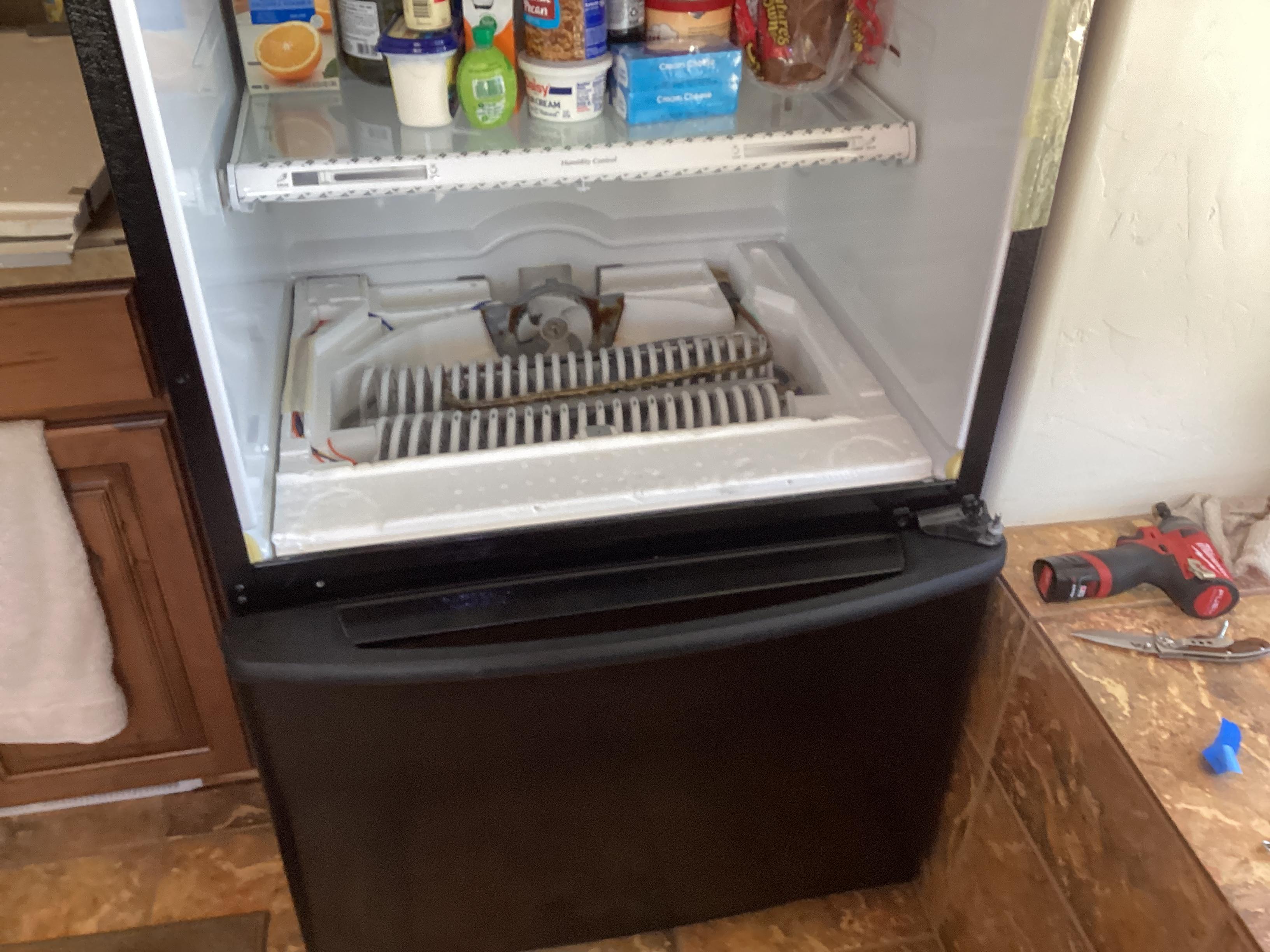

Model Number: GDS18LBABB

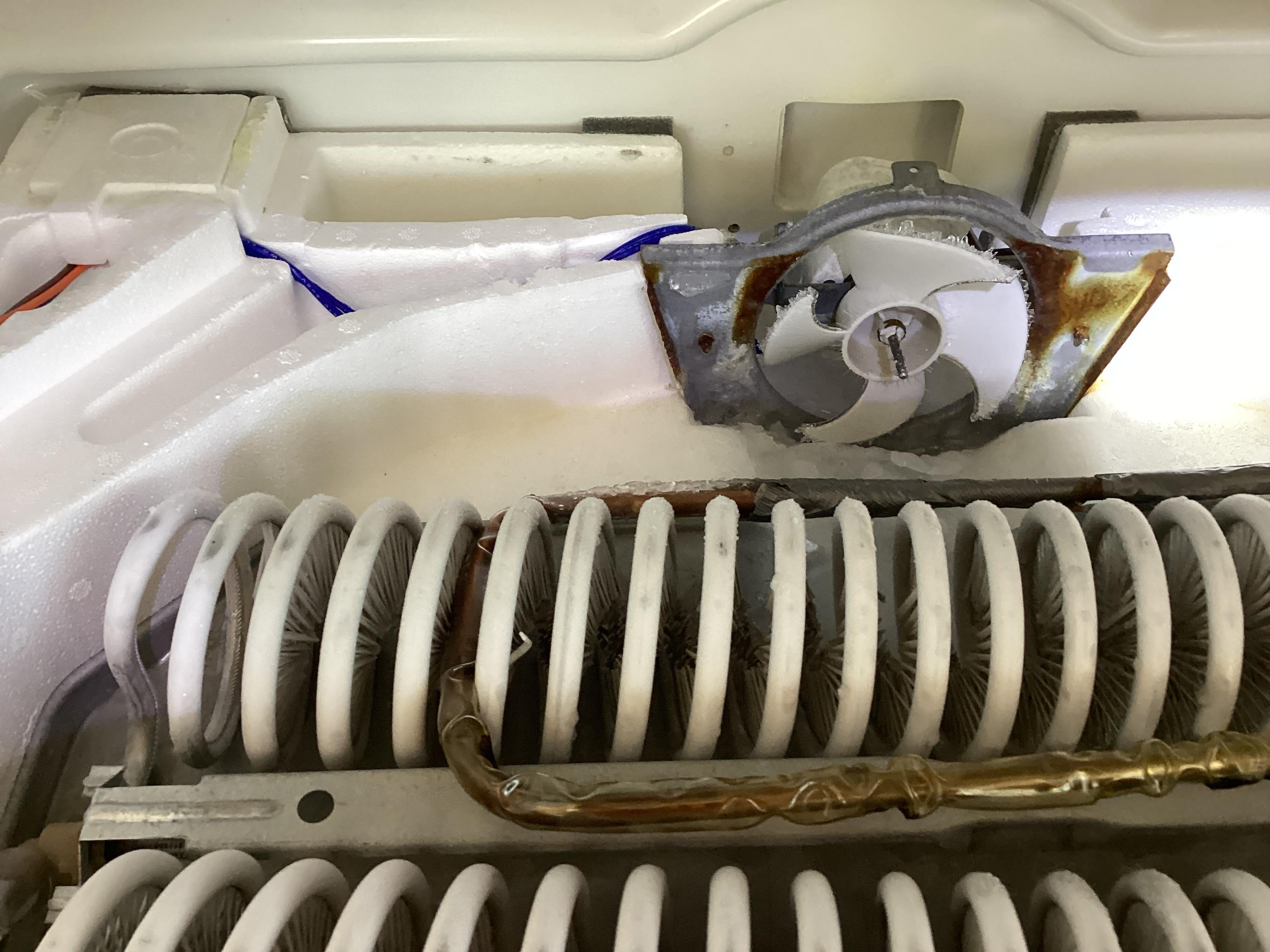

Possible FZ evaporator fan failure. It’s not hitting ice.  I believe all components are located on the top of the FZ compartment. I haven’t done a repair on this type of refrigerator. Single door,  bottom mount freezer.It must be pre 2007, GESmartHQ does not have the manuals. Thanks Captain
Captain the evaporator and fan might be below the floor of FF compartment in the area between the FZ compartment and the FF. I can hear the Evaporator fan equally in both compartments. Odd.
21 minutes ago, Rich Armstrong said:
The evaporator and fan might be below the floor of FF compartment
Is it is on this one.Uses the mini manual.
  • Like 2
@Rich Armstrong Will come apart like in this service bulletin.
Woohoo Captain, you are the man!
This one also may apply:
Those can be nightmares. Make sure the drain is clear and tilt the front legs up higher to give the defrost water a more of a chance to get out of the freezer before going back into the cooling mode!
