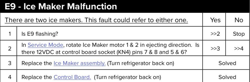

Viking Refrigerator Service Manual Request Model RVFFR336SS
Manufacturer: Viking
Model Number: RVFFR336SS
Have you validated the model number at an online parts site like Repair Clinic? (yes or no): YES
Have you watched the video on how to search for manuals and have you searched the Downloads section prior to posting this request? (yes or no): YES
Unit not making ice. Error code E9 all fans on the unit are working. temperature is good.
