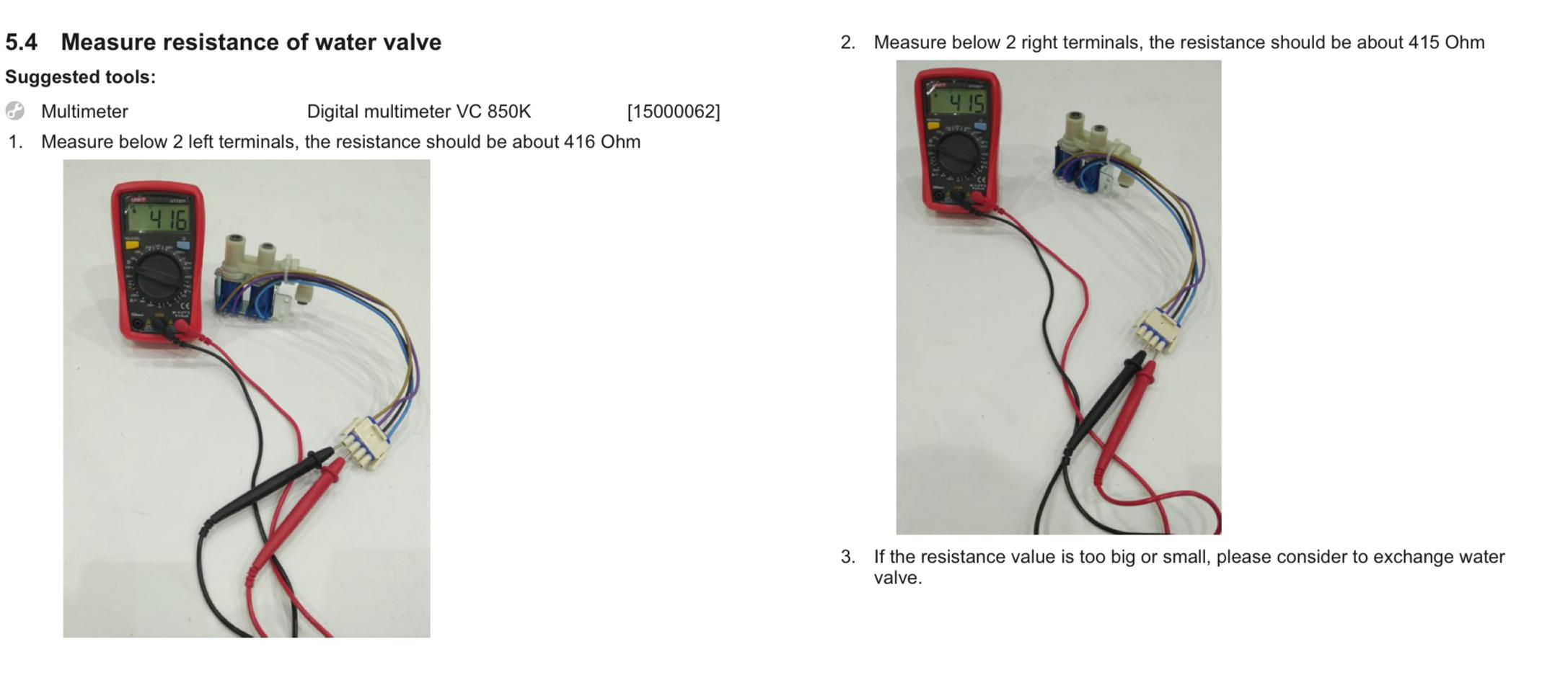

I have a Bosch Refrigerator with no water through the dispenser.  The exploded view shows that the solenoid is buried inside the refrigerator. I am hoping to troubleshoot the main board.

There’s a molex plug for the water valve on top of the refrigerator. Need to remove the top cover.
