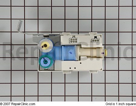

no water coming into icemaker. emitter and reciever board tested good. Ice maker went through harvest cycle and made the watervalve(with circuit board attached)Part #2305225 click (sounded like relay) but no electro magnetic valve sound and no water of course. Should I go ahead and replace this valve or is there another test I should do to make sure it's the Smart Valve or not (Smart Valve are they kidding us)Thanx for the help Dan the Appliance Man

probably do have a bad valve, but to be on the safe side you can jump N & V on the module and see if you are getting voltage to the valve for sure

Is there no voltage or continuity test I can due at the valve itself ?
So can anybody tell me how this smart valve works ? please
Not sure if the coils on the valve are AC or DC, but if you perform the jump test on the module on N and V and check your voltage accross P3 and P4 on the valve you should have your answer
