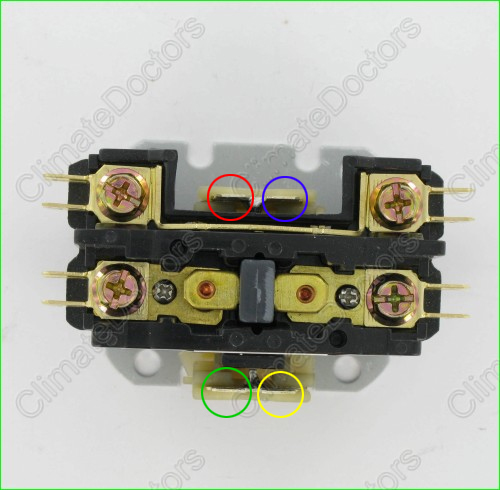

OK, now I am looking at the two pictures and I am noticing a difference between the two contactors.
The one that is currently in use has 4 blade connectors on the far right side (red wire plugged in on top, blue wire plugged in on bottom).
The P282-0311 has 2 blade connectors on each side (top and bottom in the pic), so which blade connectors would I connect the red and blue wires into?
Thanks.
(If need be, I can provide pics with arrows, circles, etc. for clarity.)
It is simple. The blue goes on one side and the red wire goes on the other side of the contactor. Makes no dif which side goes where 24 volts is alternating current. On this new contactor you DO NOT connect the wires on the same side. Instead of having the wires connect on one side, a leg of the coil is on each side of the contactor in this particular manufacture.Fairly common. If you look close the double blades are connected to each other (one solid piece). This video clear shows the basic makeup of the coil

So, are you saying if I attach the red wire to the red or blue circled blade, I would then attach the blue wire to either the green or yellow circled blade?
YEP
