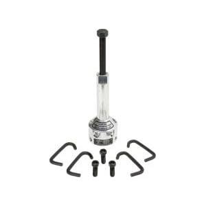

This is a great tool. Fifty bucks well spent. Pushed the motor out of the wheel effortlessly, I didn't even feel any resistance. I highly recommend it.

. . they did recommend the Ultimate Puller by Sensible Products for getting that motor out
Ultimate Puller UP-1 Ultimate Hub Fan Blade Blower Wheel Puller HVAC by Sensible Products
about $ 55
click on picture

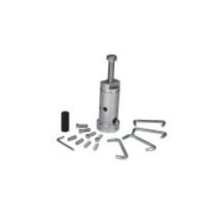

Supco FBP100 Fan Blade Puller about $ 35
click on picture

I've got the supco puller. It works, but you have to be patient to line it up correctly, make sure the shaft lines up with the hole and that none of the 4 set bolts on the puller hit the hole for the fan blade set screw. I've done this and couldn't reuse the blade due to the damage.

In regards to the pullers..I own , and have used the puller like the one in the bottom of the 2 images for at leat 13 years. I have never used the little arms that come with it for blower wheels. but it works great on condenser fan blades.... if they are not too rusted.
Tips for pulling:
1. sand the shaft so any rust is gone or very little.
2. Oil the shaft , so once the fan starts to move it does not bind. (use lubricating oil , not penetrating oil like wd40, penetrating oil is not very slippery)
3. Don't bother trying to pull a blade if the shaft and fan hub a very pitted with rust.
I have learned that when a fan blade gets to a certain level of rusted, NO PULLER in the word will ever get it off. There comes a time when you just buy that new 20 dollar fan blade instead of fighting for 5 hours to get that old rusted one off. Although anything can be separated without damage given enough time , patience and knowledge .
