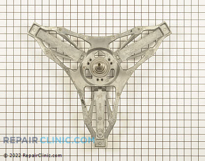

Kenmore 110.46472501 Washer, Unidentifiable Racket, Noise..video incl.
Let me know if you have any thoughts on what may be causing this racket.
hear the clunking at 0.00 and strange vibe at 0:18s

Sounds like a Tub Job comin' up.
Oh my, broken spider!
The drum support spider inside is on its way to looking like this:
this Spider ? :kopkrab:
click on picture
The very one!
Actually there was a pair of underwear that slipped through the bellow and was wedged between the drum and front panel. A result from overfilling I presume
