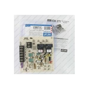

I have an older Bryant 75000 BTU Natural Gas furnace built in 1986 with a HH84AA 011 board. The thing started acting up where after the furnace would cycle the blower would come on briefly for a couple of seconds then turn off about 3 times within about 10 seconds. This had gone on for about a month.
Now the blower will not turn off at all. We have to turn the power off to the furnace to get it to shut down. When it gets cold in the house we flip the switch and after the flame goes out and HX cools we flip the switch again.

the Blower Motor is controlled by a solid state time delay circuit on the (bad ?) Control Board
So you think it is the control board?
could be...
it's 26 years old ?
I agree the board is suspect. Usually if a blower won't turn off, it's a stuck relay, but
...stuck relays don't act like this. Maybe a short somewhere but most likely it's the board.

Relay Board
HH84AA011
replaced by
HH84AA020
click on picture
Sensei is correct, this furnace does not have that kind of limit switch on it. I wish it did. Been wanting to replace the furnace anyway but not this soon, wanted to waid to the summer. So I guess it is the board now and furnace later.
Thanks guys!
Jim J
Thanks to everyone who took the time to respond.
I just replaced the board HH84AA 011 with the new HH84AA 020 and she is now humming along!!! Heating the place fine and blower turning off as designed!!!!!
