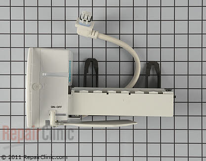

Installed new icemaker. Water valve does not stay open long enough to fill up tray. Can water cycle be adjusted like on the Whirlpool model icemakers???
this one ?
with the ON / OFF Slide Switch ?
click on picture
ICE MAKER - ICE BALL Bulletins.pdf
link PM'd
That's the one. Reduced water flow at door dispensor also. This unit has had water filter issues in the past. Gonna install new filter and see what happens.
may be clogged Screens on the Water inlet Valves ..
and / or clogged "saddle clamp" Valve.
If so, then if ever replaced, may then have too much water for the IceMakler, etc ..
It was the filter. New filter and water flow back to normal.
