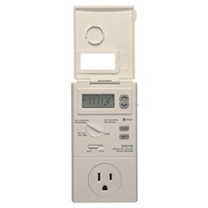

... I was thinking it is a bad thermostat but I don't know if I can replace that or not
I would think it's a bad thermostat, but I think it's NLA
You could use one of these...
from Amazon
OR may be available at Ace Hardware Stores
click on picture
