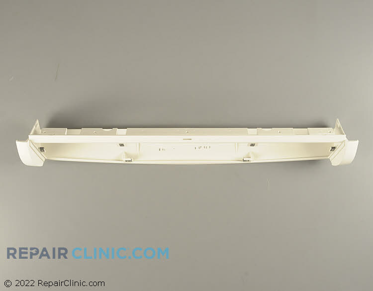

This one is allmost too embarrassing to ask but...I suspect a circuit board problem but,but...I can't get the control panel off. When you stop laughing, when you regain control and your breathing is normal...I see a couple of screws on the bottom edge but that doesn't seem to help so...I'll shut up now and wait.
(holes in # 16)
(looking for service manual)
Posted (edited)
You need to take the control overlay off first to get to the screws to remove the control panel.
Remove all the knobs and take the nuts off each control switch and the overlay will lift out the it will be obvious from there.
The nuts under the knobs are NOT what hold the infinite switches in place, they each have two normal inf switch mounting screws like you would find on normal ranges once you remove the overlay.
It took me probably 15 - 20 minutes to figure out that was the way to get in on the first one of these I worked on.
thanks a million guys - i feel so much smarter now.
