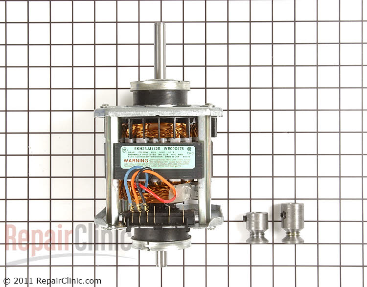

This is a GE Dryer. Customer brought me this dryer with the left side removed. And parts missing. Customer replaced dryer motor when dryer would not start. They dont know if the motor is wired correctly.
Any help would be appreciated

OK the wiring that the other guy did, as soon as you plugged the dryer in the motor word buzz. I used the wiring diagram on the tech sheet and now it does not buzz but the motor and heater comes on as soon as you turn it to any cycle start switch is not shorted it test good. I must have a couple wires messed up. The new motor is part#
WE17X10010. Repair Clinic said that it comes with instructions how to put in my customer says it did not come with any instrctions. Does anyone have thst sheet, or have a suggestin on how I can get it?
Any help would be appreciated.

OK... looks like
. . . . . . . M6 ... M5 ... M4 ... M3 ... M2 ... M1
. . . . . . .Pink . Red . Brn/Yel . . . Purple . Black

Where is M1, M2, etc. in relation to ground?
as noted on my last photo of the Motor
M6 ... to ,... M1
from left to right
there may be an "empty" M7 on the far left

it could be:
. . . .wires of the Motor . . Blue . . . . .Orange . . . . .Black .
. . . . . . . M5 ... M4 ... M3 ... M6 ... M1 ... M2
. . . . . . .Red . Brn/Yel . . . Pink .. Black..Purple
are the Motor terminals numbered ?
Posted (edited)
Just the tech sheet. I maybe able to get the Instruction Sheet for the new motor from my local parts company. But that wont be till monday. This motor is wired differently from the old motor. Yes the motor terminals are numbered.
1 at far right on picture through 9.

can you post a picture of your "new" Motor that shows the terminal numbers ?
and a photo of the Switch shown at managemylife
Posted (edited)
Tried latest configuration you sent me still motor just buzzing as soon as I pluged it in. If you goto the managemylife post link'd above you can see the numbering of terminal posts, click on the picture and scroll down to the bottom of the pic.
Also if I hook it up according to the managemylife page the motor and heater come on as soon as you put it on any cycle. I dont have a blue so I put the purple on that terminal.
