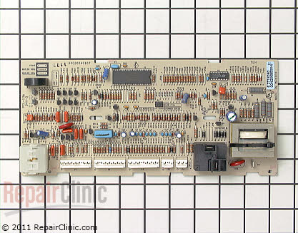

those early neptunes were pretty notorious for bad wax motors on the door latch assembly. tends to also fry one of the resistors on the control board near the bottom left. this will cause it not to enter high spin. as far as the dryer, have you verified that there is NO heat? if it does heat and is not drying, could just be a clogged exhaust

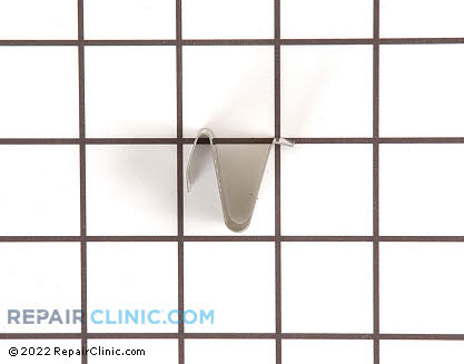

Basically, the wax motor has a shaft that it just pushes forward when it is energized, and this action locks the door, and also hits a microswitch on the other side, to tell the control, "hey, the door is really locked!" Then the control knows that is OK to go ahead and spin at full speed. So check the resistance of the wax motor, make sure its getting 120v from the control when it's supposed to, but also, make sure its hitting that microswitch. Also make sure the microswitch is actually closing when depressed, and of course check all the wire terminals to make sure they're not just oxidized and not making a good connection.
If its just a case of the shaft of the wax motor not extending quite far enough to hit the switch, that can usually be solved with just a little piece of cardboard behind the spring (#2 in the diagram above)

On the washer, sometimes the little z-spring behind the wax motor gets compressed and doesn't allow the wax motor to make the spin enable switch even when it's fully extended.   The usual trick is to stretch the z-spring a bit and then put it back in.  Or just replace it ==> http://www.repairclinic.com/PartDetail/Clip/22003717/1000770

if the wax motor was truly bad then it also damaged the main board, which is located on top of the dryer, unlikely they could get to that while in a closet
You need to look at the board. I think the resistor that goes bad is R 11 on the board. At any rate you do need to look closely at the board for discoloration of resistor. If you go ahead and replace the wax motor and it still doesn't work you may be looking at putting that board in it.
http://www.repairclinic.com/PartDetail/Main-Control-Board/22004325/1032714?modelNumber=MLE2000AYW
