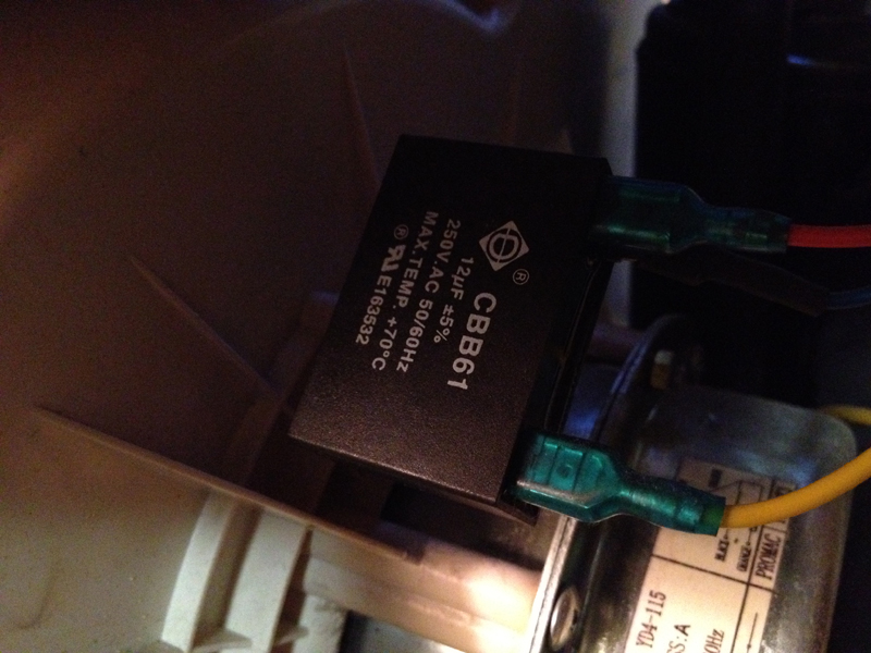

My Mom's Tili AC unit (TM111VR) is not turning off --- I turn off the power but the fan continues to run (and the compressor) when the display is off.  I have to unplug the unit for it to stop.
I opened it up and checked the board for fishy caps etc -- all looked good.  The relay on the board looked good as well.  Inside the unit there are two black run type (I think) capacitors - both 4 connector CBB61 -- different ratings --- from reading it would appear that maybe these are somehow faulty.  So I'm thinking I need to source them -- but I'm unsure of exactly what the fault is or could be, and how to eliminate the relay on the board from the issue to these specifically.
From my reading it would appear that these run type capacitors act almost like relays -- that they can fail in such a way as to be always on or always off.  Here's some photos:
Relay on the control board
The run Capacitor on the circulation fan
run capacitor on the compressor and evaporator fan
Anyone ever deal with this kind of thing?  Many Thanks

The run capacitors are definitely not the problem if the the fan and compressor are running!!!!
The fan and compressor most likely are both controlled by the same relay on the control board.
How did you determine the the relay on the board looks good?   You can't tell if the relay contacts are welded together by just looking at the relay!
If the relay that you have pictured is the only relay on the control board then this is most likely the control relay for the compressor and fan.  With unit unplugged, remove one of the wires from the relay then use a meter to check from the wire still attached to the relay and to the terminal where you removed the other wire.  If you have continuity with the unit unplugged, you have a bad relay, (points are welded together).
You could also leave the unit plugged in and off and with fan and compressor still running give the relay a good tap with a screwdriver handle and there is a good chance this would make the relay points that are most likely welded together pop loose and turn the fan and compressor off.  If this works it could work for a little while correctly but if the relay points have stuck/welded closed once they will do it again.
If you find this is the problem you could replace the complete control board or if you can solder/de-solder remove the relay from the board and source a compatible relay and just replace the relay.

Tested big relay --- didn't get tone - no continuity.  Going to test further --- but some good news:  As I was looking for sources for these relays I found a company that bought up the remaining stock of spare parts for Tili (who are themselves no longer in business).  He had several of these boards in a box collecting dust.  Grabbed one and swapped it out --- everything works like a charm.  Thanks for you help guys -- pointing me back to the relay saved me time and expense.  I may post some photos of the old board and its traces to see if you have any ideas how to test the remaining relays - just for science.  And also still quite interested -- a run capacitor -- is it essentially applifying a charge continuously after starting?  Like in the above photos the run capacitors were both 250V --- is this just a max rating or are they actually providing 250V?.

Capacitor, that's just the maximum voltage it can handle.. wouldn't be the problem
The capacitors cause a slight delay I. The AC sine wave to the second winding, this phase delay results in a bigger applied voltage to the start windings giving the motor both direction and boost. If the cap is bad the motor would hum and get very hot before cutting out on hi temp. Relays are relatively easy to test, coil pulls in to close (or open) contacts, if contact is picured as 2lines with no slash, the. The contact is "open" until coil is energized, if the 2 lines are crossed by a slash, they are said to be NC normally closed, which is they are "closed" until the coil is energized. Most relays have a common connection between the NC and the NO contacts (Normally Closed/Normally Open) and it is usually marked C (Common). With the relay disconnected from power check for continuity between the C and the NC contacts (should have continuity/0 ohms) and from C to NO contacts (should have NO continuity, and read open on ohms or inf). If you energize the coil the readings should reverse. Not all relays have both, and even when they have both they are not always used. Some relays have many sets of contacts for the single coil. Check the schematic for details.
