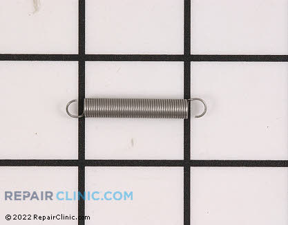

The parts list is much better then the one I was using and answered another question I had which maybe the reason for the solenoid not returning to closed position.   The parts diagram shows only one return spring on the solenoid side, (the one I'm working on has only one return spring but on the opposite side of the solenoid and there is a place for the spring on the solenoid side also).
The parts list I had didn't specify the quantity of each part used, the parts listed you included does specify two return spring, so there is a good chance that is why it's not returning correctly, (not enough spring force to overcome the residual magnetism).
Thanks this should be enough info to get things taken care of, except that the return spring is NLA - will have to improvise.
Posted (edited)
No RegUS, not that one, the one you are referencing holds the ice chute door to the strike assembly.
Part ref#31 (67339-1) Spring, Extension - RepairClinic shows expected ship date Feb.26-Mar.10 but I'm quite sure it would come up as NLA since the other 13 sites I check parts on show it NLA as of 05/2013.
EDITED TO ADD:  I forgot there are two locations at A1-Appliance showing they still have them in stock but almost $11.00 with shipping - I'm going to check the hardware stores first.
