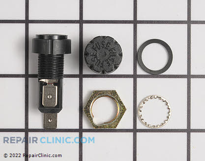

I know I'm really asking for a lot here and most likely not going to have it but worth a try!!!!
Wards - Gas Range (Convection only oven)
Mod# KTM-2390-87/18 (so far RepairClinic is the only place I can find with any ref to KTM-2390 with a very limited selection of parts still available)
Ser# 02162-8123
Lot# B
This is a WCI/Frigidaire model.
I have wiring diagram and owners manual, hoping someone has a parts breakdown and list or at least may have a part# for the convection fan motor and the 5 amp ignitor fuse holder.
I'm quite sure the blower/convection motor is going to be NLA but hoping for a part number and may be able to track down old stock somewhere.
I'm going to do some generic searchs for the fuse holder, anyone know any part# to start looking for that might be compatible, (3/16" and 1/4" terminals exiting straight out bottom - standard quarter twist-lock cap, 7/16" dia. mounting hole).
This is the fuse holder I need, (would prefer one with a 3/16" and 1/4" terminals instead of two 1/4" and would like to find an appliance part number instead of this Briggs&Stratton part#)
Briggs&Stratton Part# 191302GS

Thanks for the assist MicaBay, but I already ran across that one.
With the price for any of the Frigidaire specific parts - I will go with the $6-$7 dollars shipping + $7-$8 for the part for the Briggs and Stratton part and order where ever I can find the best deal without having to wait too long and just change out the the small 3/16" wire terminal to a 1/4" terminal.
