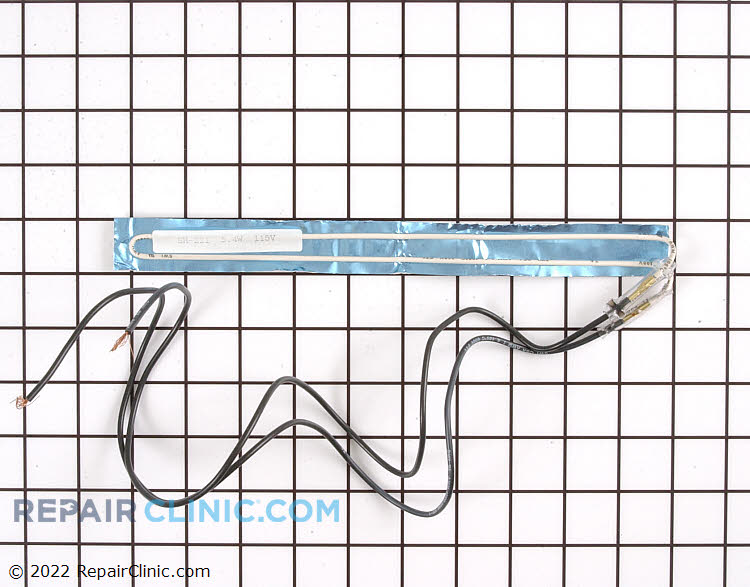

These are pesky little buggers; an electric drain heater wired in parallel to the evaporator fan motor has solved it for me.
Part number: AP4503149
I glue it to the underside of the concave piece of sheet metal that runs toward the drain.
