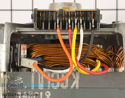

LA5000 washer does nothing when turned on the Spin Cycle (can't even hear it try to do something). I have a heck of a time with the old Maytag's and always seem to misdiagnose. The lid switch appears to work mechanically, and the fuse is still fine and works electrically. Since it doesn't do anything at all when I turn on the spin cycle, I'm thinking it's the motor, but every time I think that, it's the timer - or vice versa. Not sure how to diagnose either properly (and there's no tech sheet). Any help would be appreciated. Thank you!

Drive Motor 12002351 Main Product ViewThe orange wire leads to the Thermal cut-out, since the thermal cut-out is first in line before the power hits the motor windings, you can meter for 120VAC to ground here with the unit set to "spin" and you should read 120V if the Timer is good. The motor may not look like this, but the reasoning would be sound even on the old 'battleship' gray GE motors some of these babies have...
Does it fill and wash?  If so , go with the timer
