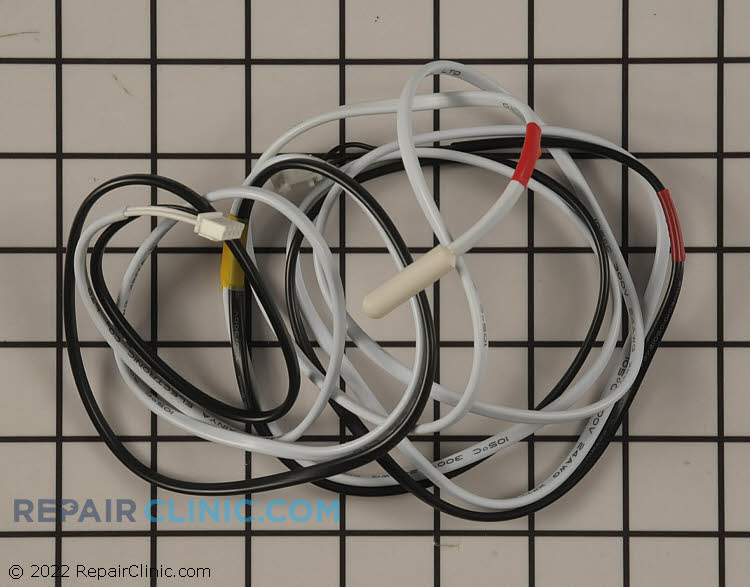

Assuming we are looking at the same exploded view, part 21 should be the thermal cut-off I tested, and part 20 the sensor referred on the wiring diagram, and the black-clad device?
I the white bulb on the end is the thermistor. If that is not reading the temp correctly then it will not defrost properly. I do not know Danbys thermistor resistance chart but maby somebody here will and chime in.
Looks like a dual sensor: white in the fridge, black in the freezer. Each has its own pair of wires.
Would that make sense?

I have a different picture for this on the same RepairClinic website, with the same reference:
Temperature-Sensor-C0817-4-7-01457728.jp
Link
Yours looks correct, but I don't find it with the link you provided. Since AppliancePartsPro doesn't list Danby, which brand have you found it under?

About the sensor, both our pictures are wrong: under aC0817.4.7, ApplianceParts shows one black and one white sensor connected to a 4-lead connector (same as sold by Danby parts department), RepairClinic shows one white "bulb" while the black lead goes to an intermediate 2-lead connector, and still goes to a 4-lead male connector.
However my DFF280WDB is different: the control card indeed has a 4-lead header, one pair providing around 12V for the fan, the other one linked to the freezer sensor through a 2-lead connector (still different than the one shown here). Danby confirmed they don't have any other part number for this fridge model.
This is very confusing, to say the least.
