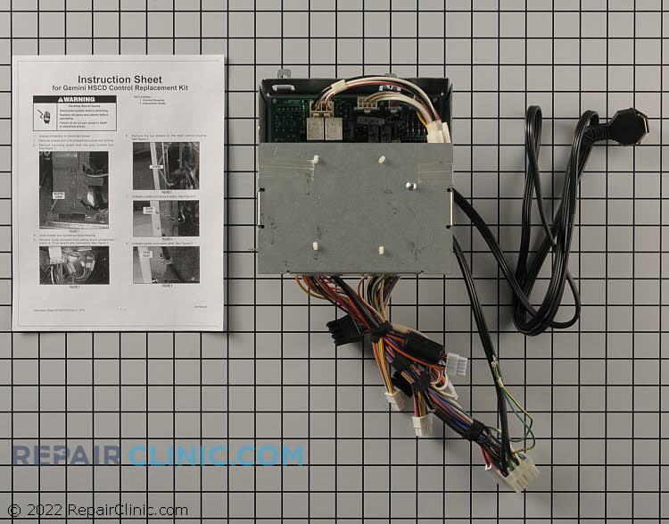

Need copy of instruction sheet from part kit# W10823804 main control board replacement for NLA W10219463
Posted (edited)
Manufacturer: Kenmore
Type of Appliance: SxS Refrigerator
Model Number: 106.44423603
Not really a tech sheet request - Need installation instruction sheet that should have came with part (Probably don't really need it, looks to be completely plug and play but would really like to see the instructions just to make sure).
I received a replacement kit for the NLA W10219463 Whirlpool refrig main control board that should come with an installation instruction sheet which is missing.
Can someone here with a subscription to service matters or someone who may have one of these in stock scan and post a copy of the installation instructions that come with the retro-fit kit.
Instructions from either of these two part numbers would work: Old# W10439326, New# W10823804
Main-Control-Board-W10823804-04756668.jp
Two service pointers in here refer to Counter-Depth and Built-In Models that use this kit, (Both omit Kenmore models).
 Attached is a "Class Code 91 letter" that appears may have been mailed out to customers who have purchased these models, it includes Counter-Depth, Built-In, Kenmore models all in one place, (Includes all brands: Whirlpool, Kitchen Aid, Jenn Air, Thermador, Dacor, & Kenmore).
WHI_WPW10219463 Discontinued Main Control Board.pdf

Any reason you are opting for the kit over having the '463 rebuilt?
Rebuild is 95 bucks and those kits are over 400!?
Thanks Thirstytech
Hiroshi, because their refrig is still working with the old board, (just chirping sometimes and condenser fan motor turning on/off intermittently but not bad enough to cause excessive hi temps).  They would have been without a refrig for a week.
My price with new board kit and labor only $427 total.
