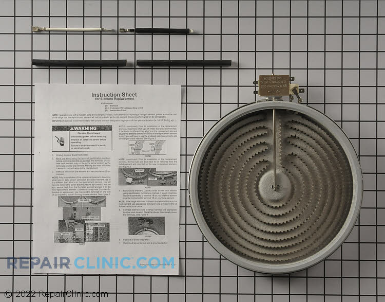

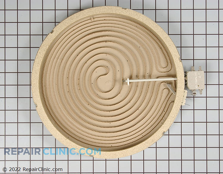

The dual element on my maytag glass top burnt out.  I have the replacement part but it says in the instructions that I need to replace the epic sensor if it's different.  The sensor looks slightly different but I don't see how the parts would swap from the old one to the new one as the sensor when it goes into the limiter seems quite different.

Which element are you replacing...?
  1. Right Front: 74008919
  2. Left front: 74009034
  3. Left or Right Rear: 74008568
The left front element comes with an instruction sheet...
Thanks for the reply.  I am replacing the front right.  It is the dual element.  The part that is confusing me is first of all some of the connections have changed and they have eliminated one wire by connecting the wire directly to the limiter.  I have just matched up the 1a to 1a regardless of the location.  correct?  The other  part is in the instruction sheet which you included in the picture.  It says to replace the epic sensor if different with the sensor from the old element.  It is different when I take off the limiter cover but it doesn't seem like it would swap over like they recommend in the instruction sheet.  Thanks for the help.

The important thing is to notice which of the terminals supply the embedded element(s), there are two that go to the outer ring and they are the two that are vertical/next to the the jumpered terminal, and there is one larger terminal opposite of the jumper... the connectors on the wires should match them in size.
The two smaller terminals will be for the less powerful circuit that the limiter uses... should be a black and a yellow wire according to the wiring diagram on Service Matters...
The configuration might be different, but there should still be five wires and five spots to connect them.
The "EPIC" sensor is not the limiter/hot surface switch, it is another sensor that is used on some of these elements but it's not real common.
Just follow the instruction and make sure you attach the wires to the terminals that are marked the same as the original element, (they moved them around a little from the original elements - if you attach the wire that came from 1a to 1a and so forth you will be fine - don't go by positions on the switch go by the markings).
