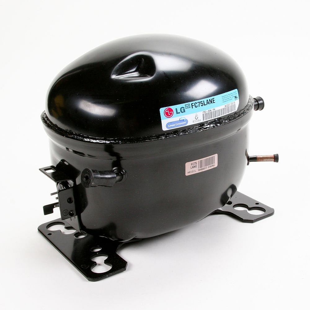

I don't do sealed system work but everything sure sounds like it points to a bad compressor and this being a LG, (I suspected a failed Linear Compressor), so I looked it up before posting.
This is one with a Linear Compressor and I would be willing to bet that is the problem - I'm really surprised no one else has already pointed in that direction.
You need to look up your warranty on this, (the sealed system may have a 5th-10th year warranty on sealed system parts only or if you're lucky parts and labor).   It looks like from the diagram lookup this was built sometime in 2010.
Your compressor  Part number: TCA34649901
PD_0046_795_TCA34649901?op_sharpen=1&qlt
Good advice Willie,
Is this a pretty common issue on this unit I have?
I am within 10 years, so that is good.
Am I going to have to dig up my receipt, and secondly how will the process work: do I have to convince them that I had 'someone' look at it and they will mail me a compressor? And then I would hire a reputable local tech to install said compressor?
Never had to make a warranty claim for a possible compressor, so I just want all the info I can get so I don't get push back from the warranty dept..
