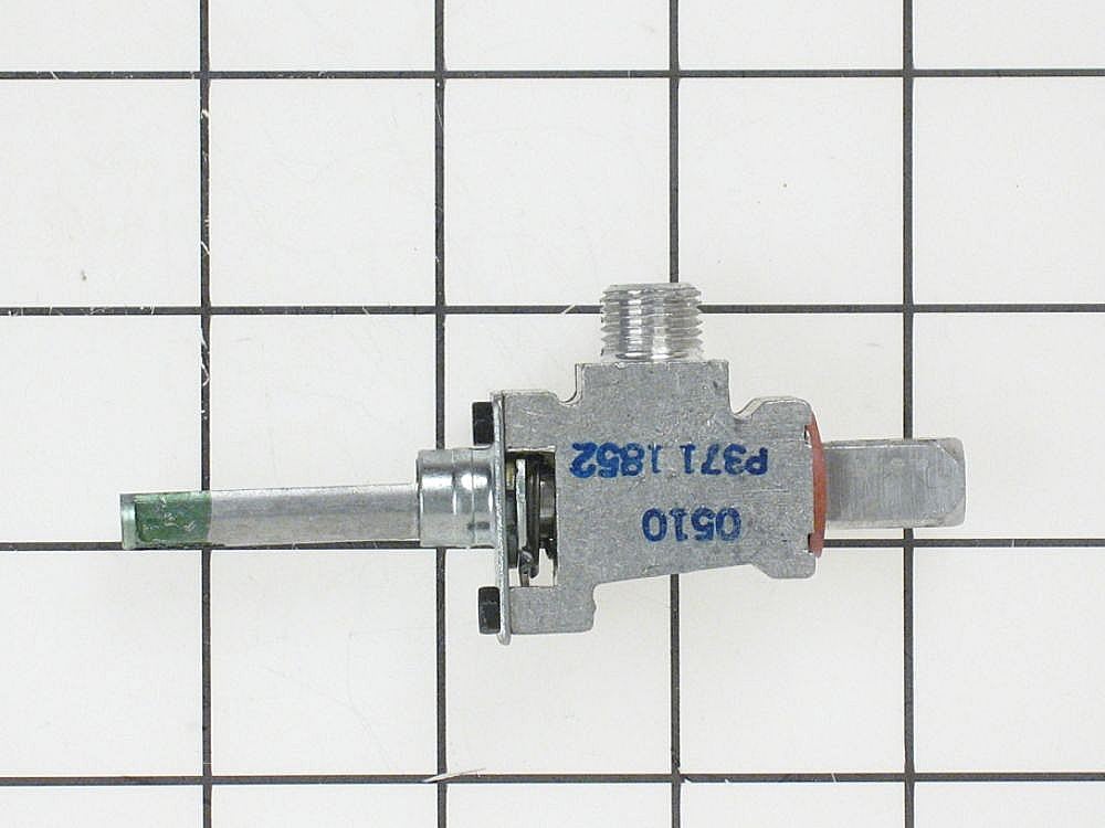

Howdy folks.  Have a couple of stuck/failed valves on said GE cooktop.  I have disassembled the top of the stove and gotten down to the valves.  I believe they are parts # WB21X5322  and WB21X5323 .  It's not obvious how these are to be removed from the manifold - all the videos I've found are for oven/stove combos and show a linear manifold vs. this round thing.  The part appears to not have a threaded end for the manifold, so does it just slide in?  Any trick to removing it?  Thanks!

Should be a screw with a gasket on the opposite side of the manifold that holds it in place. A model number would help.
Cooktop Burner Valve Part WB21X5323
The threaded part is where the tube to the burner attaches using a coupling nut. The manifold attaching screw is inline with the actuating stem of the valve.

I'm guessing those screw are under the manifold, most likely have 1/4" hex heads.

Here is a picture with the aforementioned screw and gasket, note that the parts photographer inserted screw on wrong damn end...

Great info everyone, thank you.  Glad I didn't start yanking on it :)
These things are expensive!  Reputable vendors seem to be in the $180 apiece range, ebay's got 'em for $120.  Yowza.
Even at $240 you are well on your way towards just buying a new cooktop. Are they broken or just stuck? you can disassemble them and re lubricate them with some high temperature grease:
https://www.etundra.com/restaurant-parts/tools/food-equipment-lubricants/fmp-143-1038-gas-valve-grease/?scid=scplp81455&sc_intid=81455&gclid=Cj0KCQiA6enQBRDUARIsAGs1YQgjefVAbPQi6RbHd-bezQkbjzCsvo-DEHr5tzifhCMsHe5W2FoqmOAaAiU-EALw_wcB
Believe me I'm having the same thought.  One is very stiff but is working now after cleaning it out.  The other appears to be broken, as it will rotate but a low flame stays on.  I'm keeping a large pot of water on that burner (it steams but never boils) and shutting the main valve overnight.
