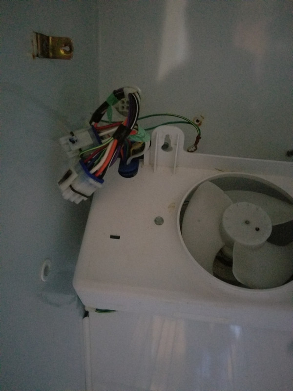

Have a question for evaporator fan motor replacement, in case of my particular model all wires are clumped together and there are 3 connectors on motor bracket. Do I have to cut the wires for fan motor and then install it accordingly? It seems like, I can't remove the connector where I can solder/connect wires outside the freezer. Is there a trick to it?
Hard to tell from image but looks like they are just taped together untape and replace fan and it’s harness.
The wr60x10074 evaporator fan comes with the thermistor. Makes installing so much easier.

I have replaced motherboard and bad evaporator fan motor, things are looking much better now and fridge is running well.
