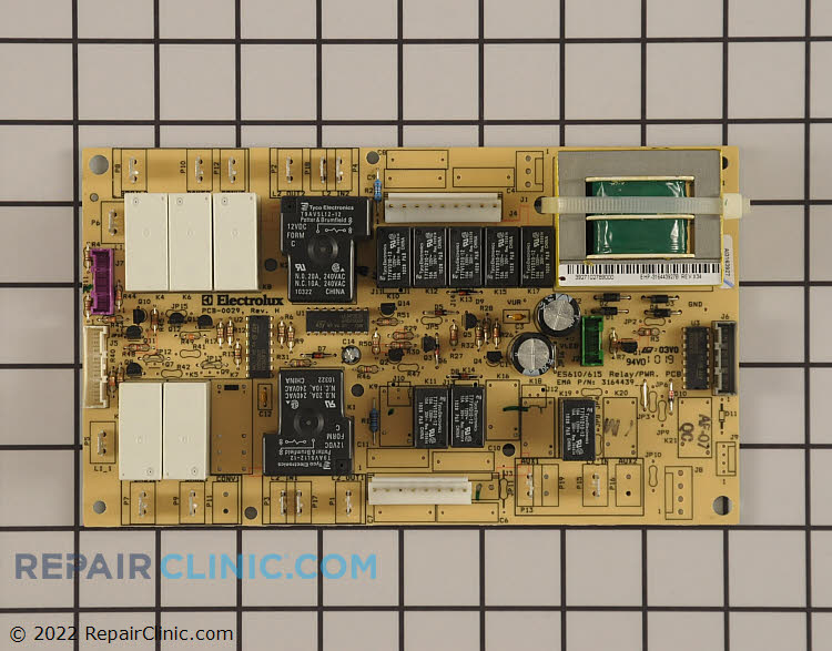

Kenmore Elite Double Oven Model 790.97313413 Bake element in upper oven not working
The bake element in the upper oven will not come on. During pre heat the broil element comes on but doesn’t alternate with the bottom element. Bottom oven works great with it alternating between the two elements. The bake element ohm’s out fine draws amperage when I moved the broil element terminals to the bake element. When it’s suppose to alternate to the bake element there is no voltage there. The control board has been replaced plus the sensor(probe). ??????
Seeing that you replaced the control board I'd say bad relay on the relay board?
Relay on the relay board?
Is the relay board up in the console?
This control board has already been replaced
You said you moved the wires and got voltage for the broiler element. Do you have a loose connection? You may have some faulty wiring or loose connections if the board was replaced.
I connected the top oven broil element wires to the top oven bake element to see for certain that the bake element worked and it heated up. So I have eliminated the top bake element as the problem. I’m thinking that the clock display oven control has two relays, one for the top oven and one for the bottom oven. It’s possible that the relay which runs the upper oven is faulty and will not alternate from broil to bake during pre-heat. The lower oven works fine alternating between broil and bake elements at least during pre-heat.
I have no voltage to the upper oven bake element when it’s on, but moved the upper oven broil wires to the upper oven bake element and had proper amps and it heated up. So my thought is that there must be two relays on the clock control board and the upper oven relay has one side of it faulty that runs the upper oven bake element
I’m doing this without a wiring schematic since I can’t find one on the unit. Can someone find the wiring schematic and post it or tell me whether there are two relays on the clock control board (part # 139092701)?
The control board pictured on this thread by Quick has already been replaced
That board is for both ovens. You have an Electrolux/Frigidaire model and I’m having trouble finding a parts breakdown with the model number you gave. You may have a faulty new board or it’s the wrong one.
I went to the Sears parts and that’s where I got the part number. It’s identical to the one Quick posted
It’s identical to the one that was in the oven that was replaced. A wiring diagram will definitely tell whether the clock control has two different relays since that’s where you turn them on at. Mind you, this is a free standing range that looks like the Maytag Gemini
Sorry. I can't take credit for posting that. You replaced what looks like the relay board, not the controller if I'm looking at that right. Might want to check connection J2 on that relay board making sure you have a good connection. Then I would maybe check connection P2 at the controller. If the connections are good I'd probably be replacing the control board. This is good. Makes me realize I need to take the range course at MST. Think I will.
So the relay board is the one show in the picture on the post above, (that was replaced)and the controller is clock and touchpad?
Yes that's the relay board.
The controller is the part number you posted yourself...part # 139092701
