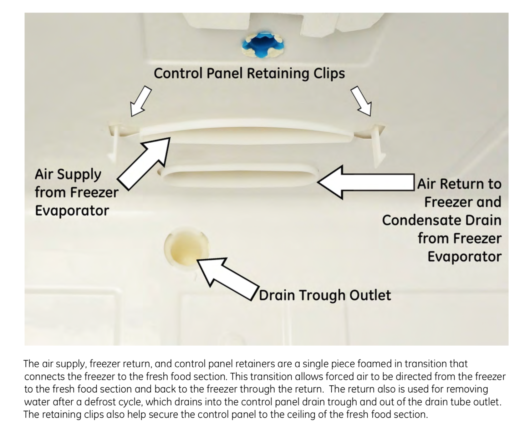

Fancy pants cheap plastic duct & console mystery. Don't want to break it to release 2nd screw to drop control.The 18' is listed, but cant find the 17model.Thanks Dyno Dave

I uploaded a service manual but you have to wait for it to be approved!  Here is a screen shot that may help you.
Here's the upload -- thanks @Captain Dunsel!
This would be that service manual!
