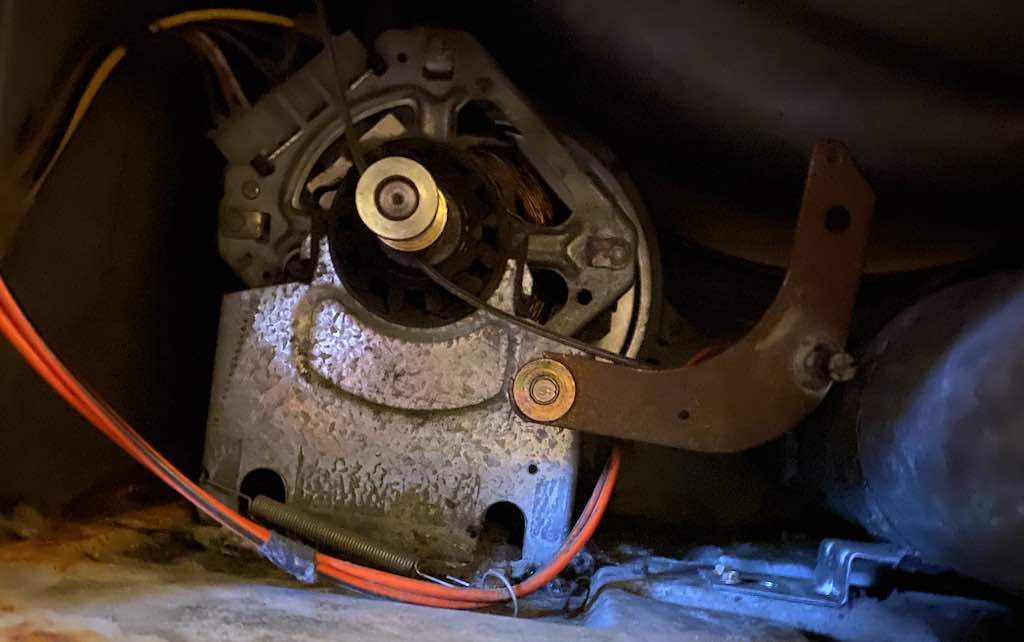

Belt kill switch found under idler pulley.
Thanks, that certainly makes sense, but even after vacuuming out, I'm not recognizing a switch. I can easily believe that I would have bumped such a thing, especially when I tried reaching back blind from the front.
Here's what I have (with the bully off and the rocker arm bac, spring down):
where should I be looking?
thanks again
hawk
hmm, I can't edit.  The image or two I find seem to show what I presume to be a mercury switch on the back of the pulley arm; I have nothing of the sort.
Here's my arm:
Also, the motor continued to run after the belt broke, but I noticed the funny sound in the next room pretty much immediately.

From your picture and my memory, these dryers don't have a belt switch.  Presume you put the belt on by removing the front panel. So the odds on guess would be door switch not re-connected. Model number would let us make better suggestions.
