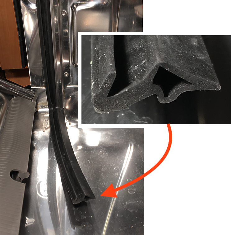

The part of the door that contacts the gasket had crud that lime-a-way couldn't touch, so I spent a lot of time scrubbing hard with a steel wool soap pad. After that, I worked the gasket into the channel but the door won't close! The picture tells the story - the gasket is not flush in the channel where it bends at the top of the dishwasher, despite all the elbow grease I could muster. I pressed as hard as I could for a long time. I was thinking of using the blade of a flat-head screwdriver to force it in but was afraid of damaging the rubber. Is there a trick to this? Maybe a different tool I can use? I have the same issue, just a little less pronounced,  on the other side. On the top & side straight sections I had no problem getting the gasket into the channel fully; in those places it sits flush.

You know, I was wondering that. I spent some time looking at the old seal and how it was oriented and tried to match the new one to that. When I thought I had it right, I could not figure out how it fit into the channel – it seemed to not fit there no matter what I tried. So I turned it around and it looked like it worked. I will pull it out and try again, thank you!
Good news and bad news - the good is that I turned the gasket around,got it into the channel, and the door closed! The bad news is that it leaks! I think I might have screwed up by cutting the ends of the gasket too short. Either that or I'm still installing it wrong – or there's some other problem I'm not seeing. But I replaced the old gasket because of a leak on the left side of the dishwasher at the front – exactly where many googles told me the door seal was the likely culprit. Directly under the dishwasher has been bone-dry.

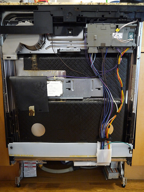

I pulled the dishwasher out, set up a light and filmed a small bit of a quick rinse cycle (youtube link below –  unlisted, I'm only putting it here). 16345Ed said it was more likely I had a door vent issue so I removed the outer door panel to check it out. There was zero moisture at the vent or directly below it. However, the insulation attached to the outer door panel was wet, in the area I circled in my picture below.

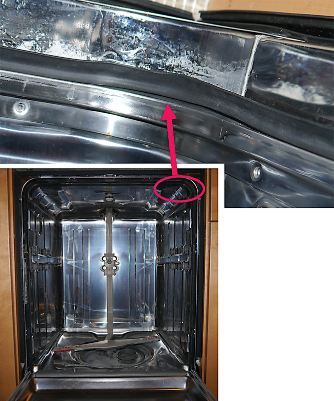

Looking at the video, my guess is that I screwed up the door seal install; the leak is actually worse than with the old crudded-up seal! If someone can take a look at my second set of pics in this thread and tell me whether or not I left enough length at each end of the seal I would appreciate it. I'm fairly certain there's less there than with the old seal.

In your inner door picture the vent seal is weeping. Vent seal needs to be replaced or sealed with silicone.  From the video make sure the DW is level side to side and slighty high in the front or level. Looks like water is being sprayed at door bottom from a leak or split spray arm.

Weirdly, I cannot get a definitive part # for the vent seal but it looks like a 8269259
Think that is the correct one. THe other way would be to remove old oring clean and coat with silicone.
Thanks Vance - as luck would have it, I found a bottle of "O-Ring silicone lubricant" I got when I replaced the diverter motor grommet 9 months ago. You just saved me $20 and a week's wait for that part.
The vent has what looks like a solenoid-controlled "flapper" valve I'm guessing opens up during the dry cycle. The surface is rubber and it looks a little crudded-up from the hard water & soap deposits so I'm gonna try cleaning that off and applying some of the silicone there. Not gonna try disassembling anything though!
Of course things can't just "work out" when it comes to my DIY attempts. That o-ring in the vent is proving very difficult to remove. I'm working very slowly, going around the housing using the flat end of a small plastic spudging tool, trying to not damage the seal. I also applied some silicone lubricant and tried to work it in there hoping it would loosen, but it hasn't really budged. Are there any techniques the pros use that might help me? I may need to get a new seal.

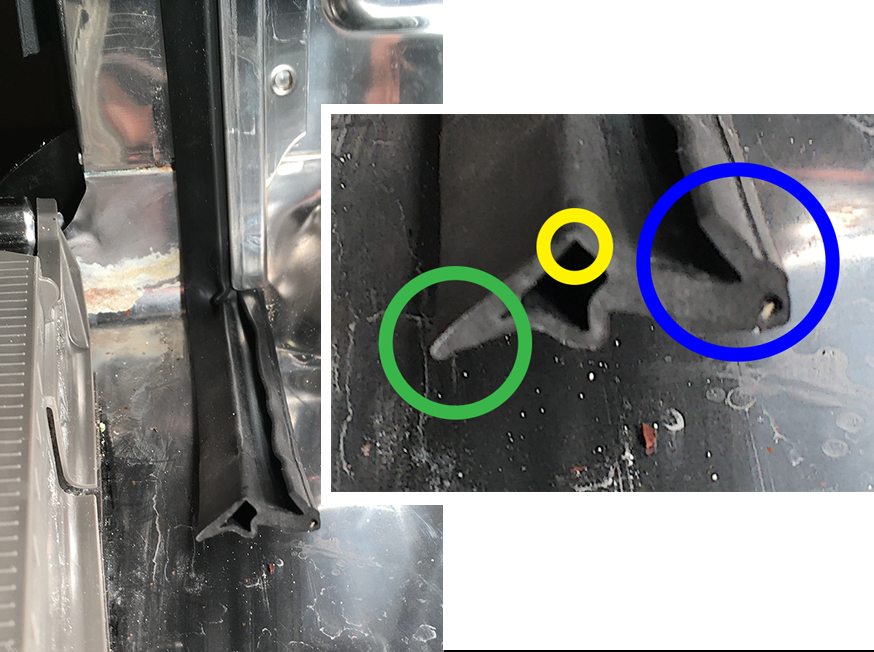

I have to admit I feel very stupid - but I want to make sure I'm not screwing up. Everything is back together and I'm ready to fire up my DW to see if the leak is fixed. However, I'm still not 100% sure I'm orienting the door seal correctly. Would somebody please look at this picture and tell me if I did it right? The door seems to be closing, although not as "firmly" as before, which I understand is normal. Thanks a zillion!! (I know, I'm gonna cut the ends short once I know for sure that I've done this right!).
Blue circled area would go into the track or groove. The green circled area would be pointed in toward interior of the dish washer. The yellow are would be to the outside cabinet area

Thanks for the quick reply. Is it upside down now? Maybe I'm just misunderstanding your wording.
My wife is getting worried about me. And very much breaking my stones right now - deservedly I guess!
In backwards, the yellow sould be outside touching the cabinet.  Nice looking circles.

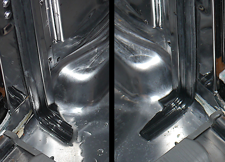

Almost. I thought I had it - I ran an entire "quick rinse" cycle (about 18 minutes) with the DW out of the cabinet and it did fine. Got it in and now there are just a few drips of water happening. Nothing like before, only from the left side (as I look at the DW), in front. I figured it was the door vent since I never replaced the seal and might have screwed it up trying to remove it. I took off the front panel to take a look at it, and everything inside is dry. I'm at somewhat of a loss here. The next thing I thought is that the DW must not be leveled correctly since there was no leak happening with it out of the cabinet. I have the install manual and a level, and adjusted the legs as directed, but the leak is still happening. The only thing I can think of doing is raising the front more. One thing – I did not cut the ends of the door seal yet, they are extending into the cabinet about 6" on each side, could this in any way be a factor? I can't see how, but maybe it is. I was going to cut them once I knew I had the leak fixed. Thanks for any words of wisdom!
Since I replaced the lower door seal and the leak is coming from only the bottom, I thought I'd check the screws holding it in. The hex head of the screw on the extreme left (where the leak is) is deformed in a way that a socket won't grip it at all (I'm using a 3/16" socket and it works on the other screws fine). So, I either overtightened it when installing, or I never got it tight enough. I know you're screwing into plastic and I thought I was careful while tightening but there you go. Well, the saga continues but this does look like the culprit. If I stripped the plastic, is the seal toast or would you use a plastic repair compound to fill in the hole and drill a small pilot hole to get a "second chance"? Thanks as always for any help, this is turning into quite the ordeal by now!!

Not sure about which piece your talking about, the gray plastic trim in your last photo? Is it out of place? Check the lower spray arm for clogged holes ans split seam.
Edited by Vance R
Yes, that grey piece. Kenmore/Whirlpool calls this the lower door seal – though I don't know how a piece of plastic with no gasket is supposed to seal out water. I'm fairly certain it's in place since all the screws & holes lined up when installed it. I remember tightening them a little at a time and it looked fine to me. There are five small hex-head screws holding the seal that are not easy to get to. The head of the leftmost one is definitely rounded, and no socket I have grips it (I tried some metric sockets close in size). However, in late-breaking news, I just moved the DW into the cabinet for the 2nd time and fired it up to see if I had made the leak worse with my shenanigans – and now it doesn't leak!
I'm about to do a full wash cycle and see what happens. Not too sure how to proceed here... I guess if it continues to not leak I'll just roll with things the way they are. Thinking of how to get that screw out does not make me a happy guy.
