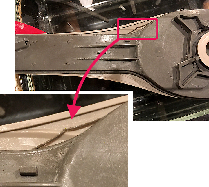

Hi, I'm back still working on a leak in my dishwasher (Kenmore 66513543N411) despite saying I was "throwing in the towel" in the long thread detailing my fruitless (so far) efforts to fix it. I had the light bulb go on and am guessing that since I replaced both the main door seal and bottom seal (with the help of Vance, thanks again!) it could be a bad spray arm – and one of Vance's early posts in that thread said " Looks like water is being sprayed at door bottom from a leak or split spray arm." A video I posted at the time now is making sense - you see water splash out the bottom when the cycle starts and the arm starts spinning. At the time, I took the arm out and examined it but saw nothing obvious so I moved on to the seals. Recently I looked again and saw what looks like a split in a small seal that sits between the two halves of the arm:
I've tried ordering a new arm but everybody is OOS on this one. I was wondering if the experts thought that 1) this could be the cause of my leak, and 2) there's any way to fix this, even temporarily – silicone caulk that spot maybe? It seems like the two halves of the arm are glued, am I right about this? I'm happy to buy a new arm if there are any out there, but I've searched the net and nobody has stock. Thanks for any help!
There are not really repairable however you can try some epoxy might work,  good luck

Epoxy is a good idea, thanks! I had the feeling there was no way to get this apart.

The new spray arm fixed my leak. That ends a one-month adventure and fishing expedition that I'm guessing any pro would have diagnosed and corrected in five minutes. In a nicely ironic touch, the spray arm is of course one of the easiest parts to replace, needing no tools and about ten seconds to replace.
I did learn quite a bit about how my dishwasher is constructed, and having a new door seal and lower seal is not a bad thing – the originals were crusted with hard water & detergent deposits. Where those seals were attached, I wound up using steel wool to clean up the stainless as best I could because a lot of that stuff was not coming off easily. I will now regularly use the "Glisten" machine cleaning product and watch for any more deterioration. If we had more money in the bank I would consider a water softening system for our house but that probably won't happen, not in the immediate future anyway.
I'll add one more thing in my lame defense - the bad spray arm passed my visual inspection way back when Vance mentioned it as a possible culprit. The "fix it yourself" youtubes tell you to look for an crack or split in this piece and I didn't see one. On another more recent inspection I caught what I took a picture of and posted in this thread's original post – a tiny piece of a very thin gasket-like "thread" protruding maybe an inch. If any other amateur like me ever stumbles on this thread, take this as a piece of advice – a defective spray arm may look OK when it isn't.
