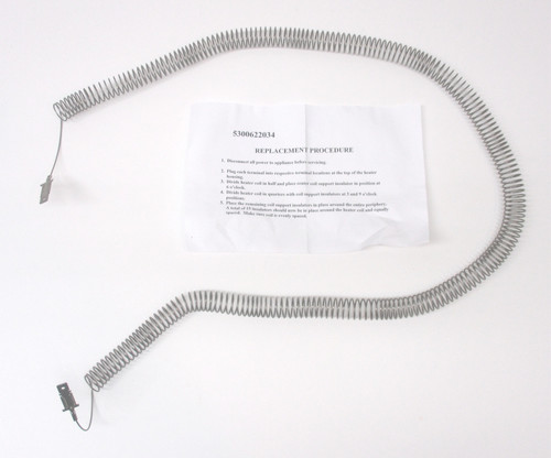

It is the dryer.  Cannot turn it by hand.  True, if the blower wheel is jammed up, the motor will not turn...BUT you should still be able to turn the drum with difficulty.  The belt cannot totally prevent the drum from turning.  Rear ball and socket bearing can totally fail...BUT...should still be able to turn the drum with force.  Something is holding onto or interfering with drum movement.  I just want to be armed with likely parts when I go back to repair.  Any help anyone?
So the usual failure with rear bearing is the ball wears the plastic cup and start sqeaking. If you lube the plastic bearing at this time the squeak will go away for a year or 2. If you don't lube the plasitic bearing it will wear faster and the metal bracket start rubbing on the shaft of rear bearing. This rubbing wears the shaft and will cut the ball off the shaft. Odd part is just before this happens the sqeak stops. Once the ball is cut off the drum will drop slightly and jam againist the element pan. Sometime it touchs the element and takes out the element.  So my swag is rear bearing kit and element restring kit.
Vance, I think you are correct on this one.  I am not sure what the "element restring kit" is though. Could you please clarify..thank you
Instead of the pan assembly you replace just the element:
Dryer element part number Q622034
