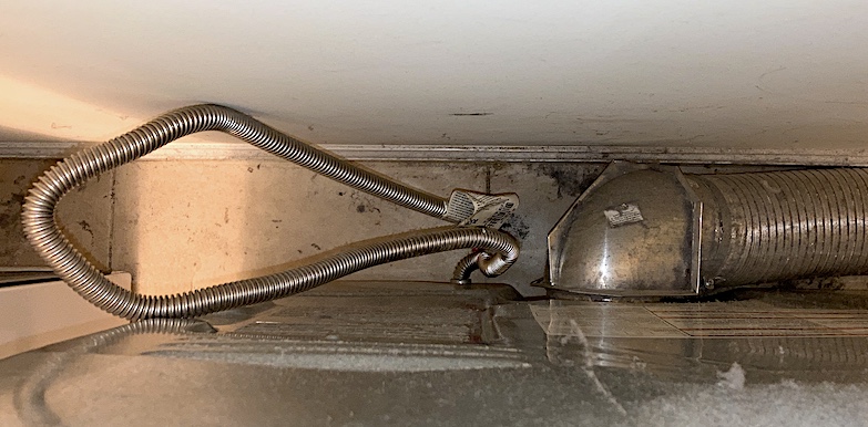

Well, my record is intact - no more squeaking. Thanks again, and please pardon my asking one more question. Here's a pic looking down from the back of the dryer. I see the propane supply hose is sorta contacting the vent hose, which obviously is going to get at least warm if not hot. For all I know it's been like this the last 5 years (that's when we got this dryer). Am I being paranoid in thinking a gas supply hose shouldn't be too close to any heat source, or is this not anything to worry about? Thanks!
Not the best routing, should be easy to move.

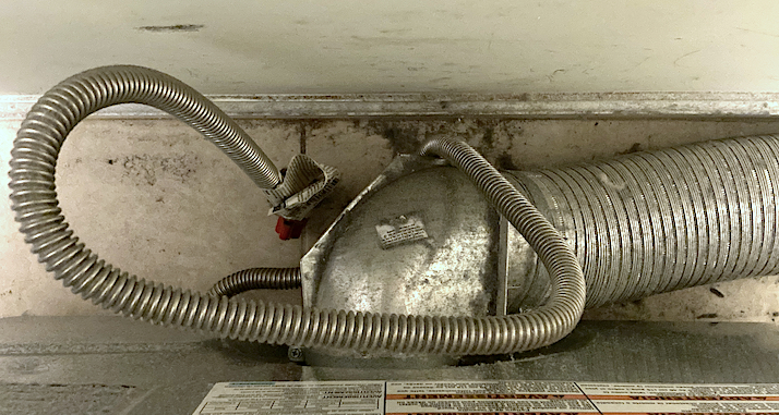

Ahh... I'm an idiot, I didn't realize how rigid that hose was, I bent it at a few places and things look better now, I think. The bends do look a little less "gentle" than before but I assume this will work OK:
Looks good and you pushed it back couple of inches.
Vance, thanks for putting my mind at ease. Have a nice holiday!
