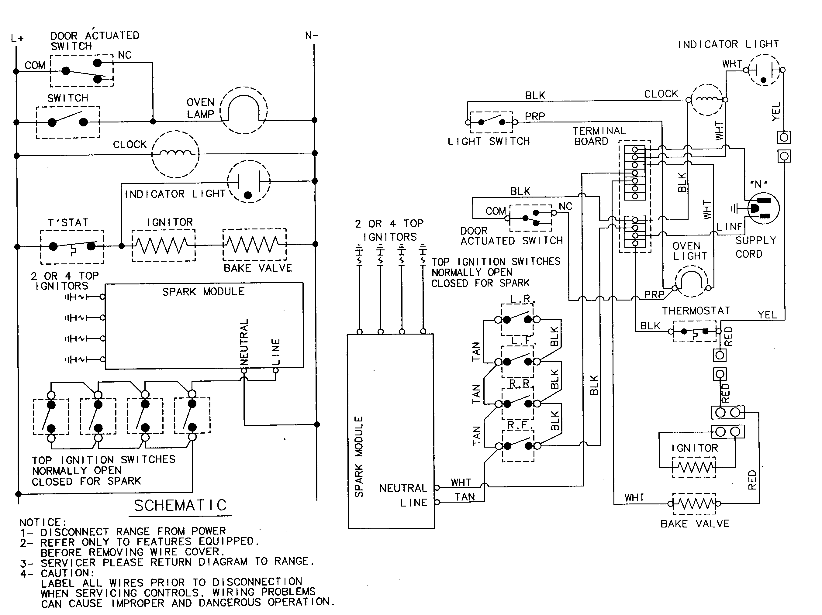

Manufacturer: Maytag
Type of Appliance: range
Model Number: PGR4410BDW
Going out on this unit tomorrow. Customer complaint is the oven turns it self on periodically
Go to servicematters Limited Access. https://servicematters.com/en_US
Put your model number in where it says part number and then click on Parts List and download it. I only see a wiring diagram on the last page of the Parts List. No other wiring comes up at servicematters for this old girl:
Posted (edited)
It's a mechanical thermostat -> igniter -> gas valve.
The only thing that could turn it on is a bad thermostat which is backordered.
Here's the wiring diagram for posterity, in case the parts list disappears some day. 8-)
