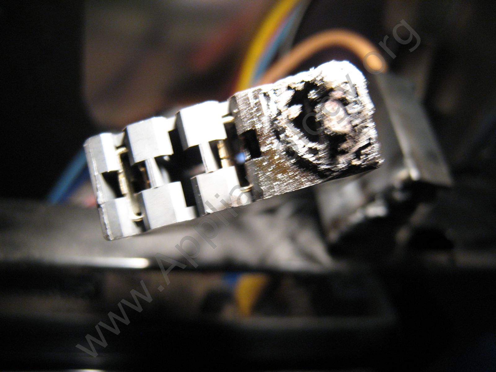

Burned Wire Harness Connector - Kitchenaid Dishwasher Control Board
This is what caused the whole problem. A loose connection in the harness connector generated all the heat that burned up the board and took out the thermal fuse on the board supposedly to protect against this type of thing.
Kentucky Fried Control Board on a Kitchenaid Dishwasher
