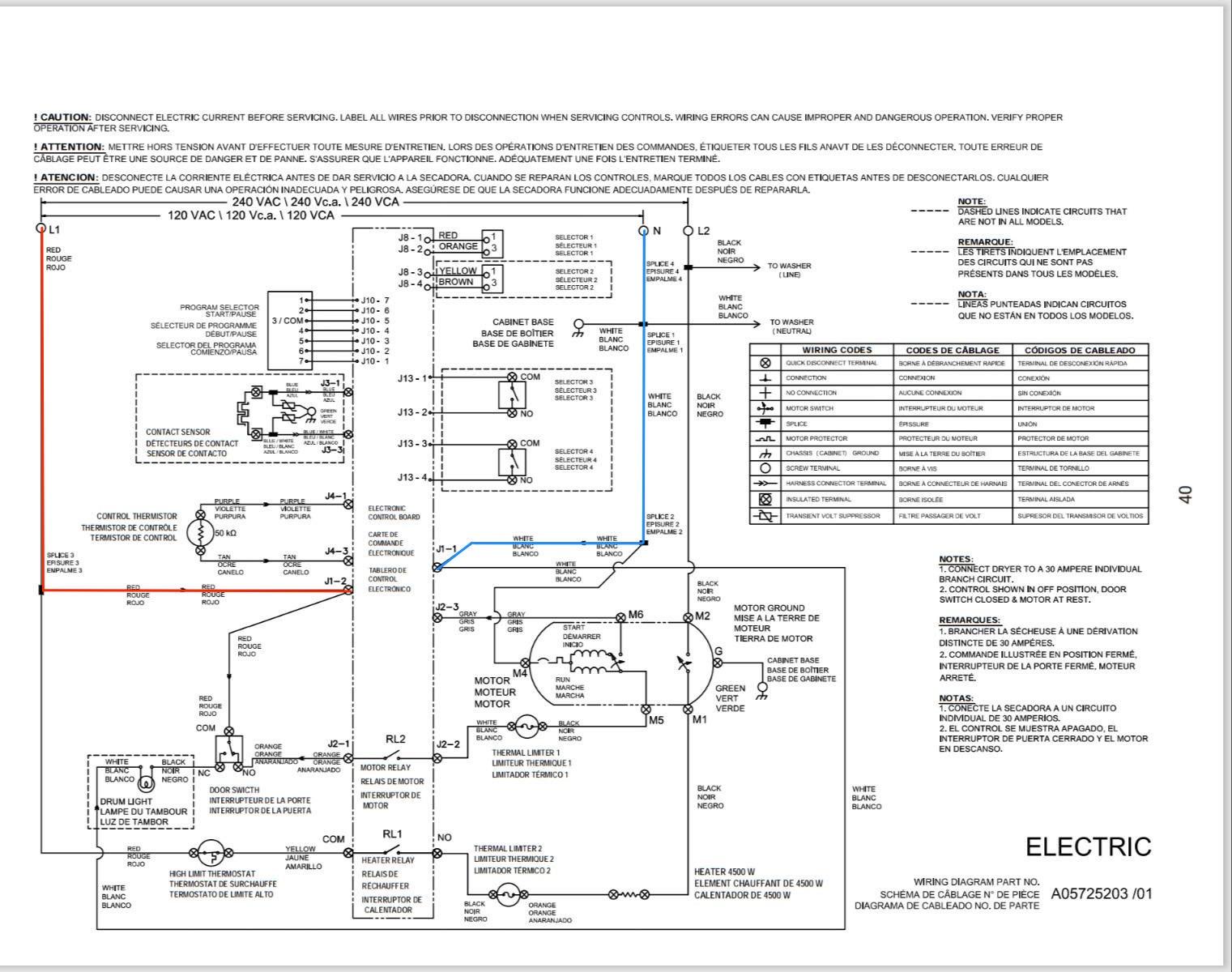

Let's crack out the schematic and find out. Here's the dryer schematic with the power supply to the board marked up.
As you can see, the board's power supply is L1 and Neutral. There's no switch in either Line or Neutral going to the board -- the board is hardwired to its power supply. That, combined with the fact that, even when we measure at the terminal block, we get 0 VAC from L1 to Neutral, seems to indicate that we're missing L1, probably due to an open in the wall outlet or the house wiring.

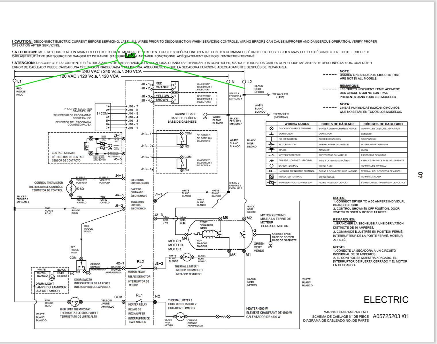

But how then is the board coming to life during our L1 to L2 voltage measurement? Well, let's look at what we're doing on the schematic when we perform that voltage measurement.

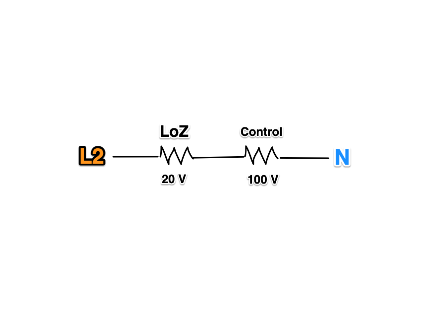

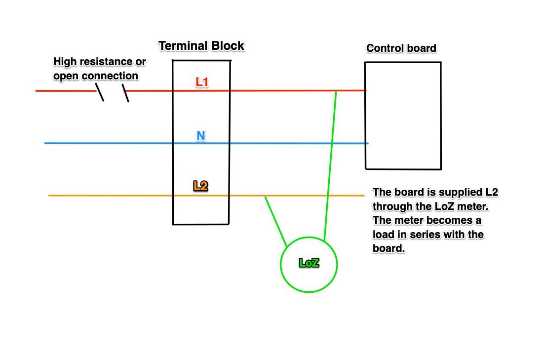

How does connecting the meter like this cause the board to come to life? It's because we are connecting L2 to the L1 side of the circuit through the loading meter. Here's a simplified drawing of what's happening:
We are effectively creating a series circuit with the loading meter and the control board. This also explains the weird voltage reading we got measuring from L1 to L2 -- that's how much voltage was being dropped across the loading meter.
This is what that circuit looks like, drawn out as a line diagram.
So there you have it -- a weird problem with whacky symptoms that turns out to have a simple solution! All of this came from a missing L1 at the wall outlet, the kind of thing you can easily catch by taking a measurement right at the outlet with a loading meter.

Thank you for the line drawing of L2 to neutral series ckt. It really helped me to see the serial ckt.
