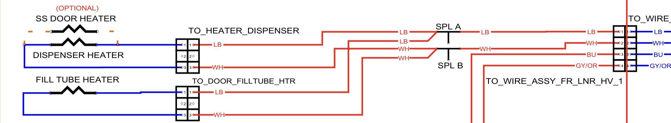

Are the dispenser heater and fill tube heater in series or parallel? Or perhaps they're neither?
BONUS QUESTION: If both heaters have 6.3 kohms of resistance, roughly what resistance would you expect to read from pin 1 to pin 2 of the connector?
Sound off in the comments!

I am assuming SPL A and SPL B, stand for splice A and B, then I have to say they are in series, because both heaters have the same voltage source and the same return path to Neutral. I may be wrong though. Total R should be 12.6K ohms.

On second thought, if each load can reach directly to the Voltage source and to Neutral independently of the other load then they must be in parallel.

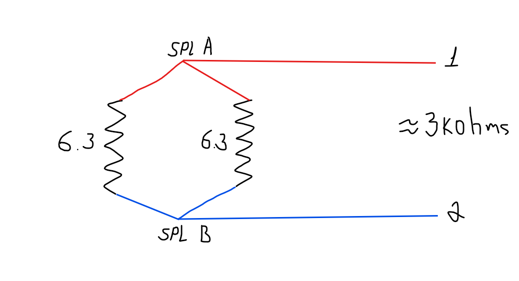

If you redraw those splices, it becomes easier to see that they are in a parallel circuit. That means the total resistance should be about half the smallest resistor (without using the formula🤪). Since they are both 6.3 kohms, I'd say the total should be about 3 kohms.
  • Like 3
JohnC
I’m seeing a parallel circuit with a total resistance of 3,150 ohms.
Slav’s drawing helps visualize it.
Son of Samurai
Great sketch, Slav, and you're spot on! It's a parallel circuit, and the equivalent resistance would be something in the neighborhood of 3 kohms.
