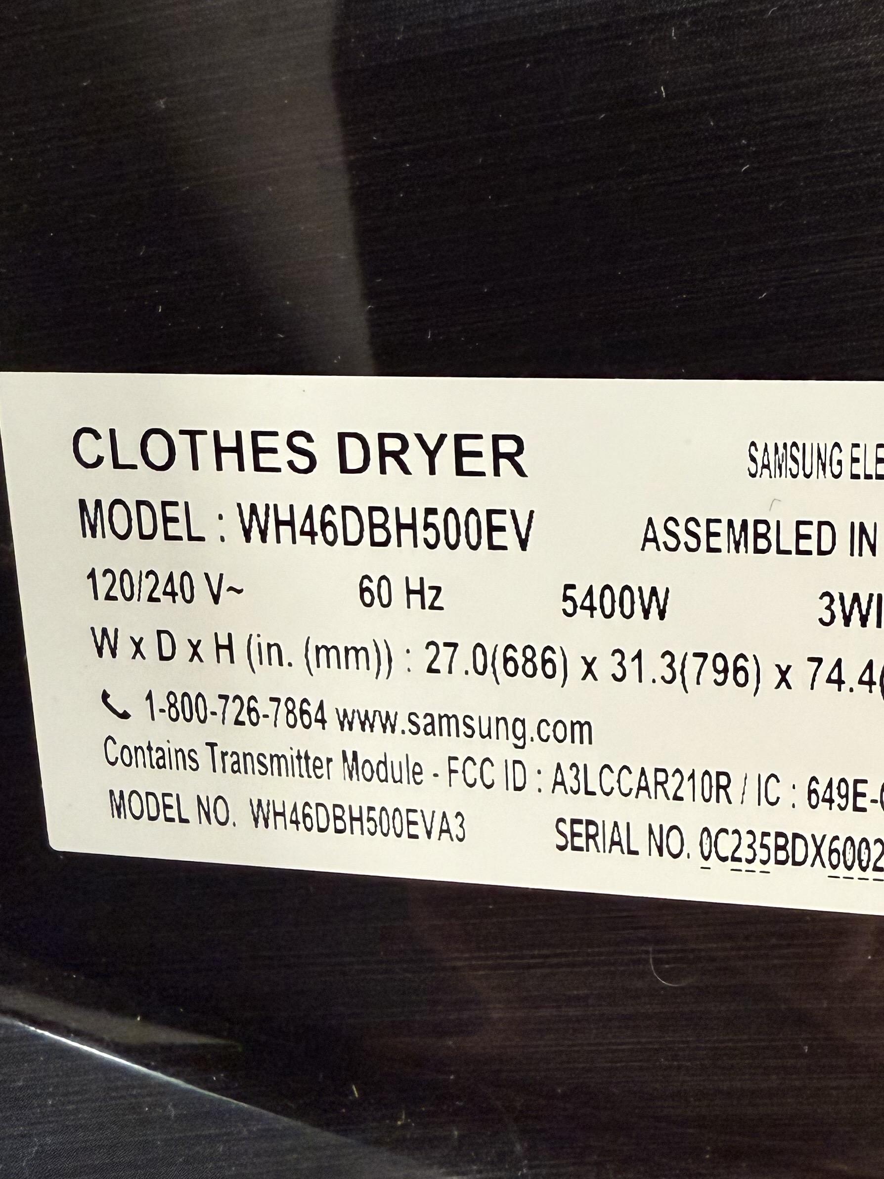

Manufacturer: Samsung Type of Appliance: Stacked washer & dryer Model Number: WH46DBH500EVA3 Have you validated the model number at an online parts site like Repair Clinic? (yes or no): Yes Have you watched the video on how to search for manuals and have you searched the Downloads section prior to posting this request? (yes or no): Yes
