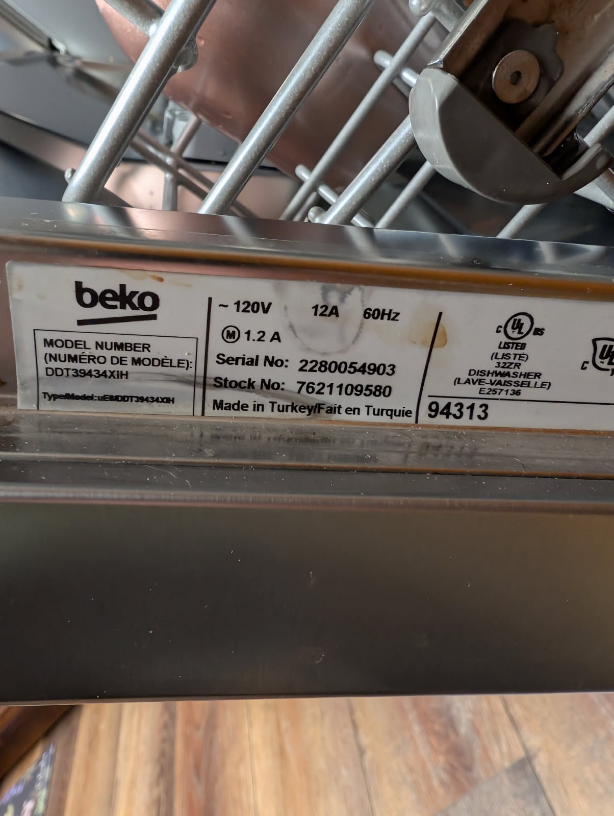

Manufacturer: Beko Type of Appliance: dishwasher Model Number: DDT39434XIH Have you validated the model number at an online parts site like Repair Clinic? (yes or no): y Have you watched the video on how to search for manuals and have you searched the Downloads section prior to posting this request? (yes or no): y Hello all, wondering if you have any Beko manuals DDT39434XIH
