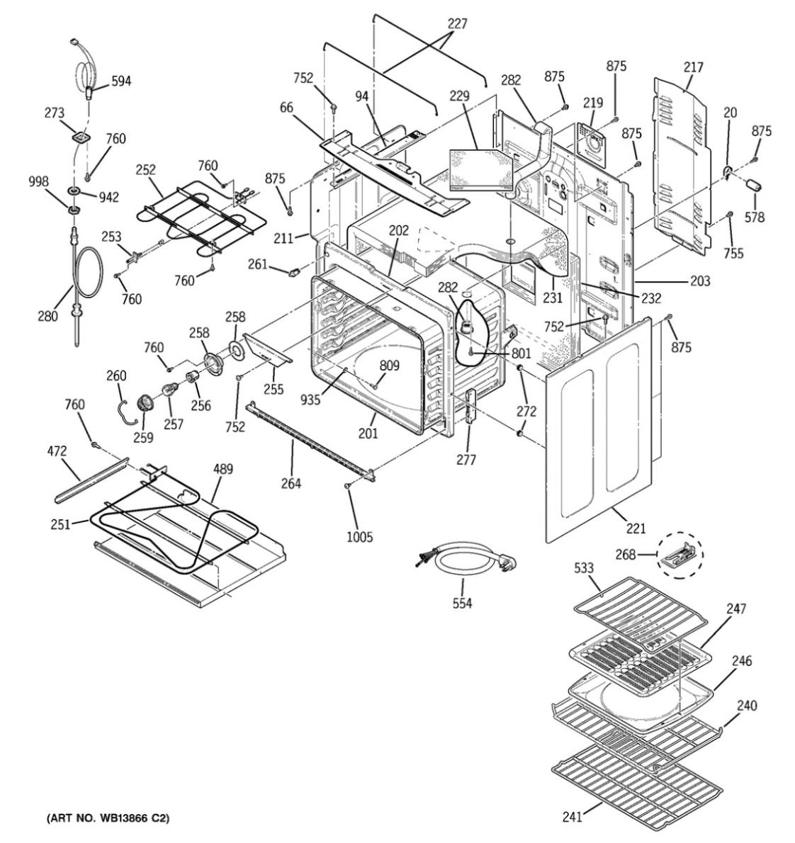

GE Profile Range - Oven now heats VERY slowly
Akshesh replied to DIY_Hopefully's topic in DIY Appliance Repair Help
Check this video similar to your Range. Also, I see attached exploded view of parts. But please double-check as this is for the closest model number match. Check 4 parts mentioned below for this issue: 1) Bake Element 2) Broil Element 3) Oven Temperature Sensor 4) Oven Control Board -

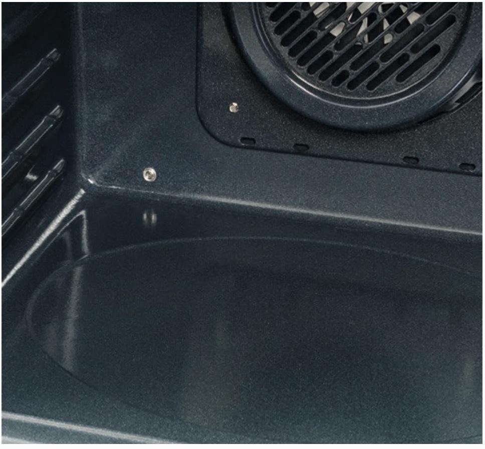

DIY_Hopefully posted a topic in DIY Appliance Repair Help
My GE Profile Electric Range model JB910B LGSS recently started heating the oven VERY slowly. It seems to reach temperature (at least to 400 degrees) but takes nearly 1 hr. There may have been some food that spilled into the convection fan in the back, causing a spark. Any advice most welcome. The element is not visible so any links to access the element also most appreciated. Didn't want to replace the element if it might be something else, considering it does heat up - just VERY slowly now. - Last week
