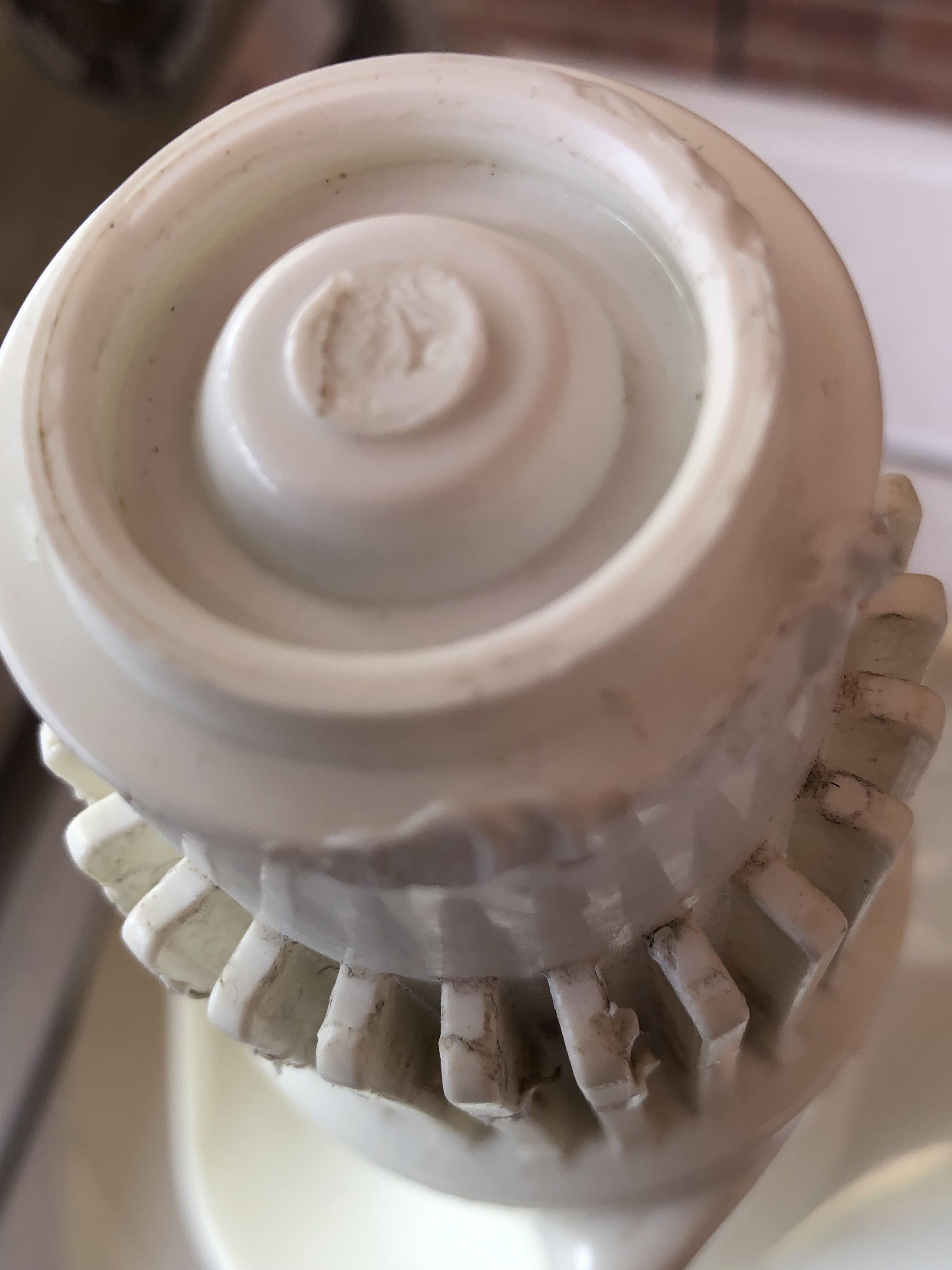

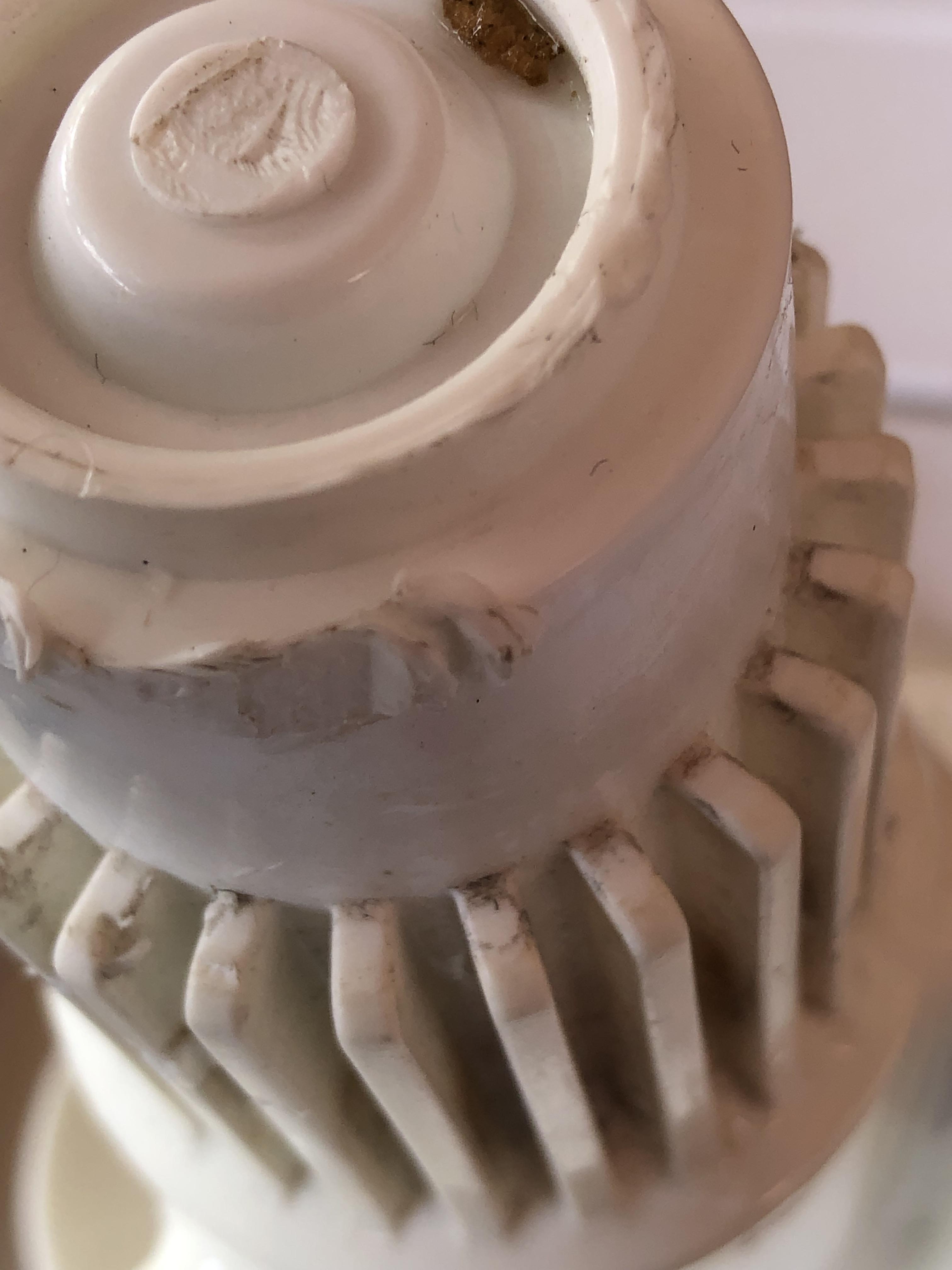

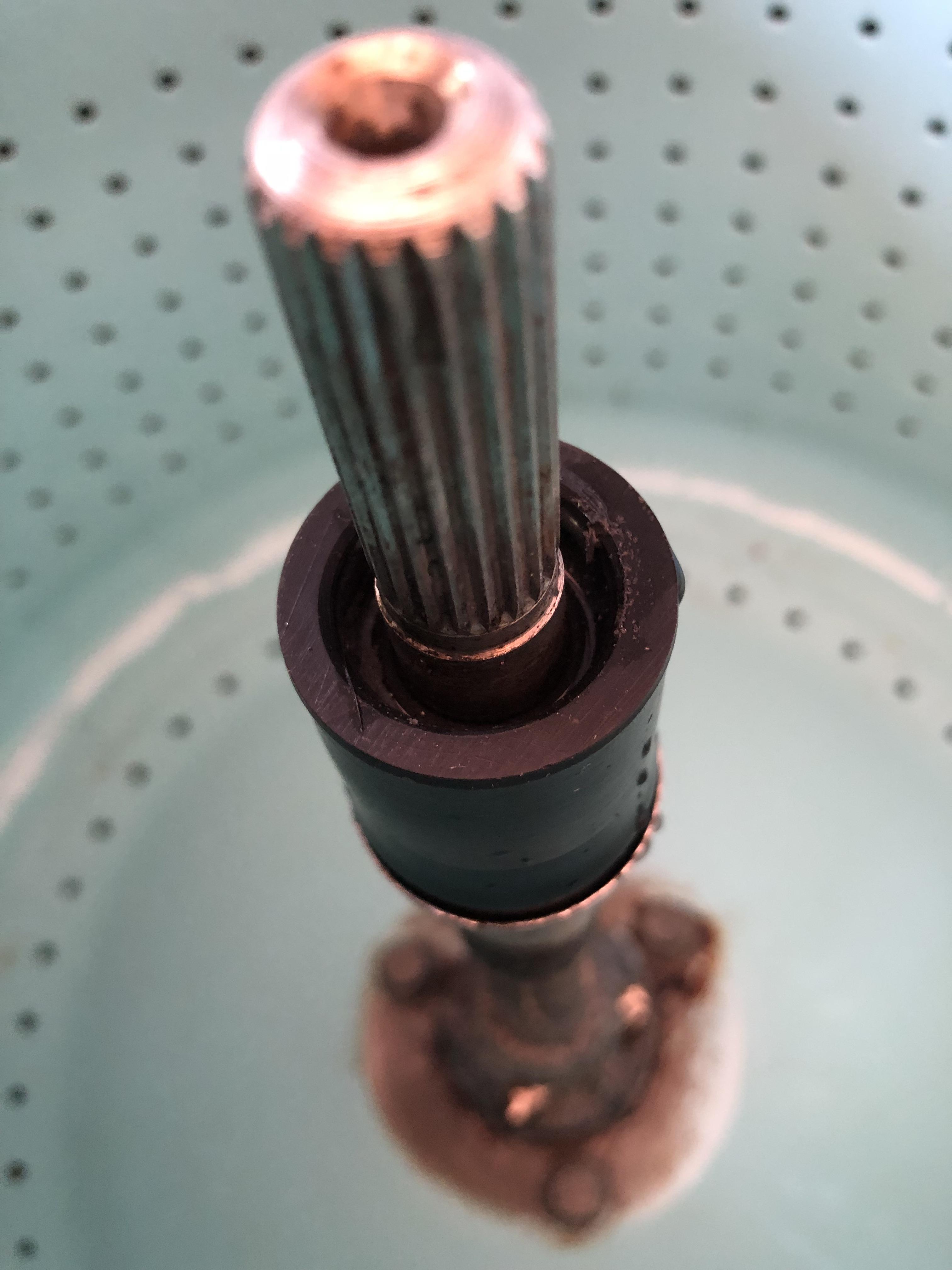

  5. Captain Dundee THANK YOU for the link!!! I’ll search it for an Assister / Agitator Assembly. As I replied to Citizen X, I am more confident that the (plastic?) female splines in the top of the Assister / Agitator must be stripped. Since the top of the Assister / Agitator has a removable cap, I would think there would be access to replace such female spline coupler, but it doesn’t seem so.

  8. THANK YOU Budget Appliance Repair!!! The model / serial number tag just where you said to look. Guess I was too blind to see it the first time. It is indeed as GE Model 1WA 952B9 W S/N MB128 235.
