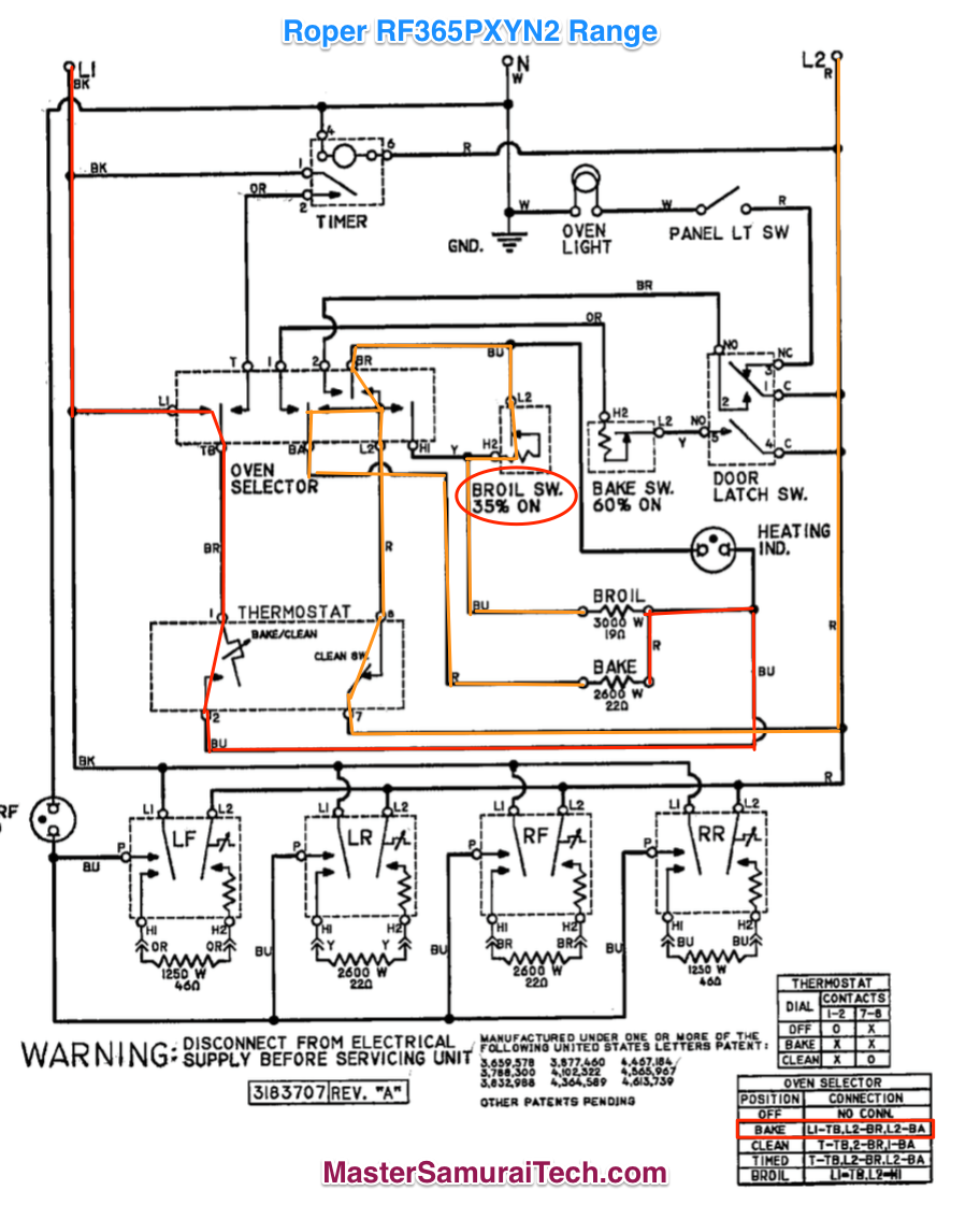

Roper RF365PXYN2 Range Bake Circuit
On this range, if the cookies are burning on the bottoms but staying uncooked at the top, check that 35% broil switch and make sure it's not stuck open.
