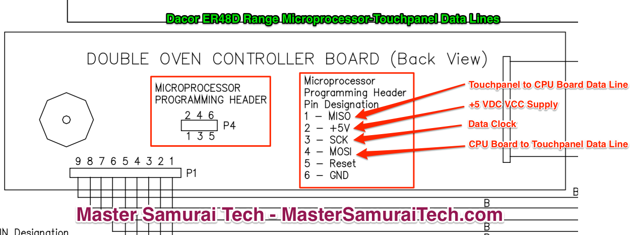

Dacor ER48D Range Microprocessor - Touchpanel Data Lines
MISO - Master Input Slave Output
MOSI - Master Output Slave Input
SCK - Serial Data Clock
