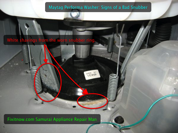

Maytag Performa washer with a bad snubber ring assembly

Therefore causing unit to shake excessively. Just the same theory as the old Maytag dependable care washers with the felt pads.
