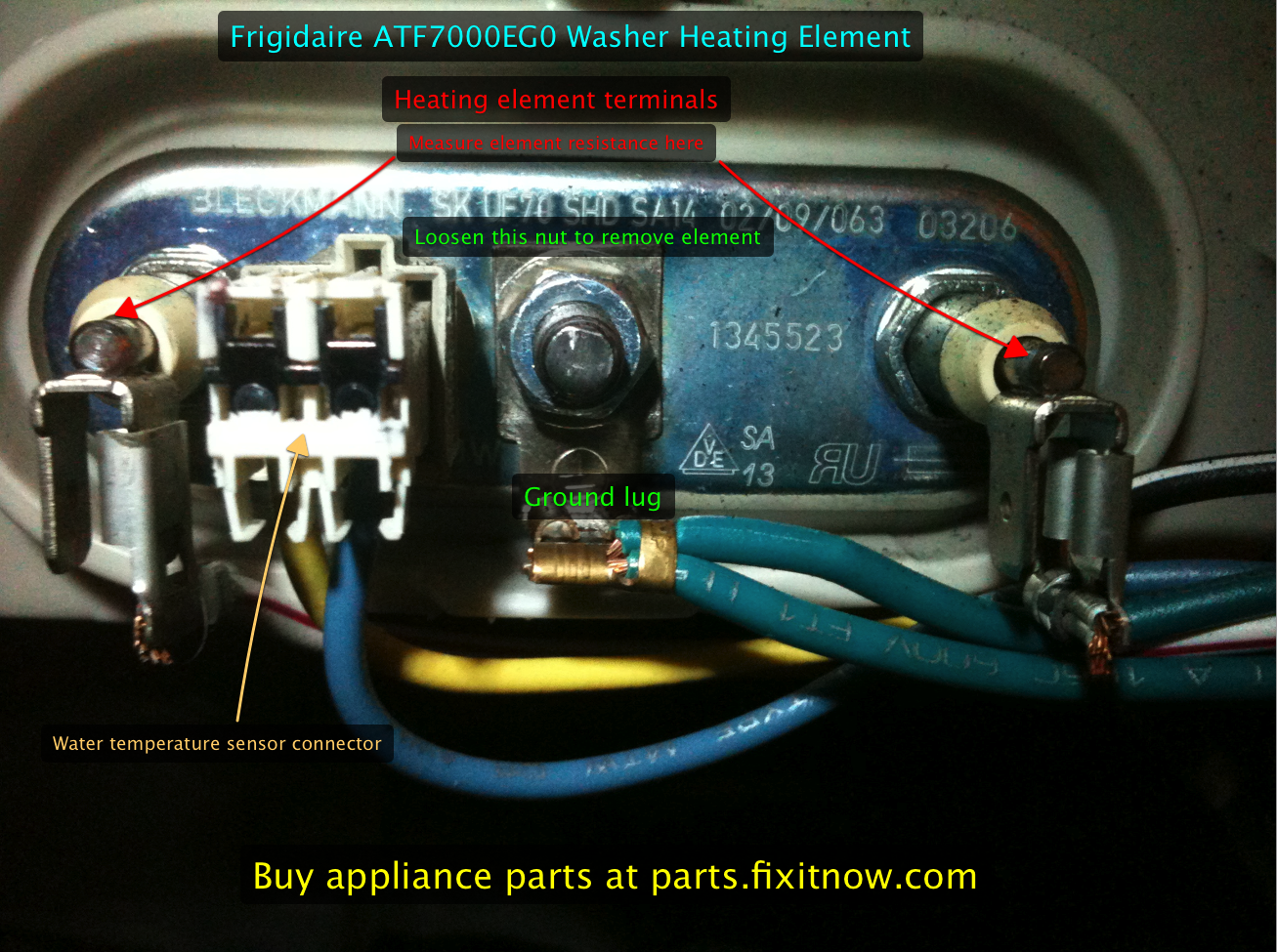

1000 watt heater, 120vac, 14.4 ohms, drawing approx 8.33 amps. Also shown is the Water temp sensor. Also known as Positive Thermal Sensor. 4.8 ohms at 77 degrees.
