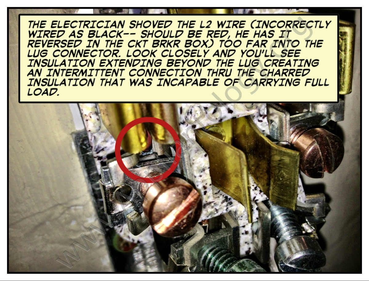

Defective Wiring In An Elecrtic Dryer Outlet Causing Intermittent L2
Watch the full saga in live action here:
