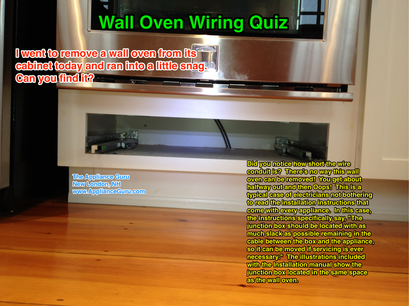

Wall Oven Wiring Fail
See the installation manual for the spec here: http://manuals.frigi...n/318206002.pdf
Those specs are typical for all manufacturers.
Bottom Line: You need to have enough slack in the power wire conduit to be able to remove the wall oven from its compartment.
